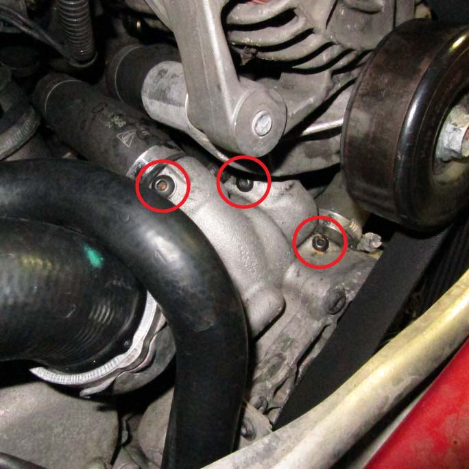

My question is two fold:
1. Has anyone here had a coolant fitting pop loose besides one of the 3 in the back of the motor by the water pump? It seems all the ones I have read about are one of the three in the back.
2. Am I correct in assuming that the 3 rear fittings are accessible for pinning with the motor staying in the car with minor disassembly? I'd like to pin the most failure prone fittings now and do the rest when the motor comes out.
Thx.
I think that the answer is "yes" to both questions. I never lost any of them myself, but I know that the one behind the power steering pump has failed for several people. I had the three on the water pump housing done last year, and my tech was able to do them with the motor in the car. The one behind the power steering pump is also accessible with the motor in place.
For the oil filter bracket fittings and crossover pipe, fugeddaboutit. Motor has to come out for those.
Jon
Thx Jon. That's what I wanted to know. So I can pin 4 out of the 7 fittings without having to drop the motor.

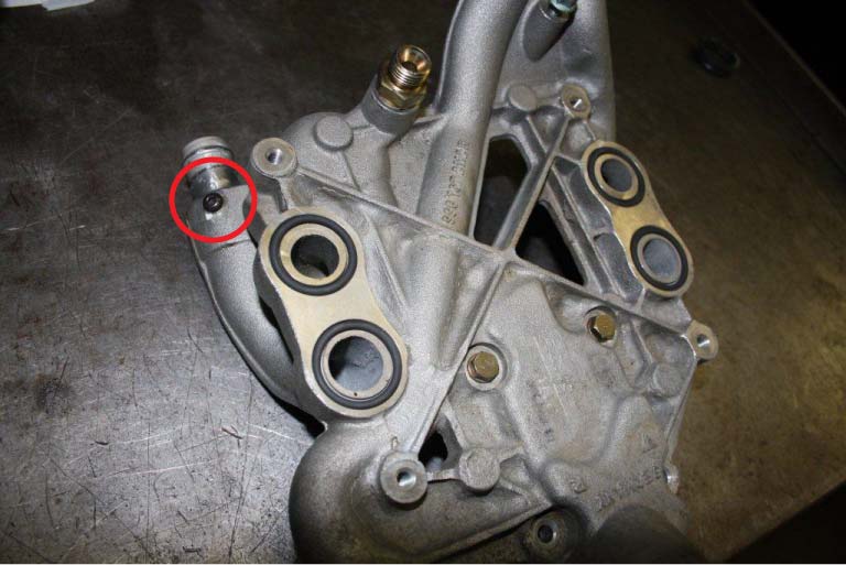

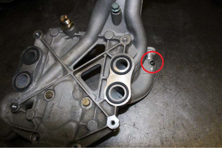

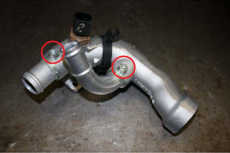

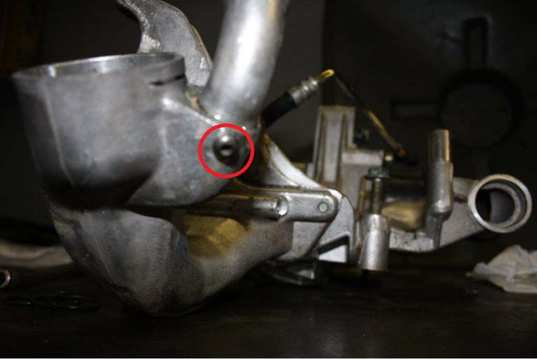

There are 8 fittings to be pinned, not 7. 2 on the oil filter bracket (note two photos, one for each side), 2 on the connector pipe, 3 on the water pump housing, and 1 on the pipe behind the power steering pump. The 2 on the oil filter bracket and 2 on the crossover pipe are pretty much inaccessible with the motor in the car. See jpfilp's thread on this for the authoritative details:
