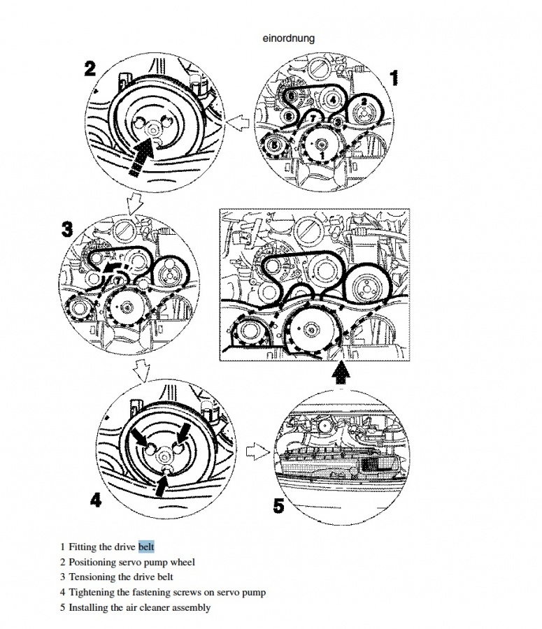

If that noise was not there before you better look at the routing of this belt and also the movement of it with the air box removed. Of course you will get a fault because you are running the engine at idle without the MAF but you should try to look at it. Just remove the air box and look at the routing. (see picture)
