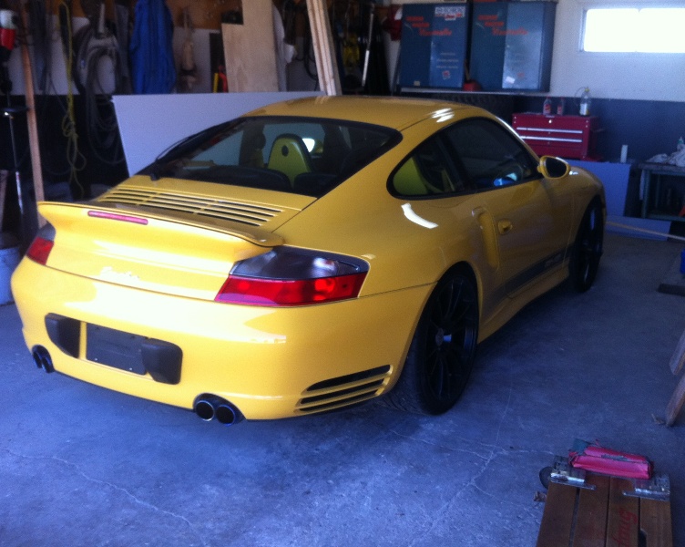

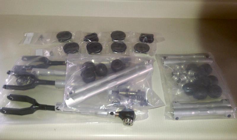

So I walked into the shop this morning to start my day and look what someone had placed on the work bench...
Yeeeee hawwww let the fun begin.
And I want to thank Tom at Champion for getting this all together. It took some time but he was the only shop that actually followed through with there promises. I was trying to throw a large fist full of cash to several shops that advertise on here and none of them seemed to need the revenue. And likely my most problematic purchase was these items and Tom took care of me. Thanks Tom!!!!!!!!!
Next up, Ohlins TTX shocks, sway bars, tranny mount, engine mounts, and rear subframe bushings and brake upgrades.
The only thing I am not sure of yet is what sways I am going to use.
2 Pic's, Parts on bench at work, and Car sits in storage bay at home getting dusty, Now to bring them together.
I am going to do the mods pretty much one piece at a time to see what I think.
Dog bones first once I get my upgraded rod ends. Then I think tranny and engine mount, maybe subframe too. Then shocks and brakes later this summer.

Also add drop links (unless your going to get blade type sway bars Tarrett Enginering) and rear toe steer links. I'd do the suspension mods all at once so you're not paying for labor and alignment several times if you do them as one offs. Also if you plan to change wheel and tire size do this before the alingment. I'd also consider the 997SS shifter. Consider the motor and tranny mounts as a system. Either get the 964RS engine mounts and 997 tranny mount (Suncoast) or the Wevo semi solids with the AWD teflon filled tranny mount.

The Ohlins are BALLER! You will feel a HUGE improvement from those alone. The dogbones, not so much as there is still so much slop in the lower control arm, caster arm, subframe bushings, engine mounts, tranny mount and chassis that there will still be plenty of slop to go around. Coilovers and sway bars make the biggest dent in responsiveness.
Dog Bones are overrated IMO unless you are just trying to get your alignment right. I'd invest that money into some lower control arms instead.
BTW where did you source your Ohlins?

+1 re dogbones, waste of time/money.
The most squirm sits in the rear toe links so get adjustable with solid ends, especially noticable if you go RWD. Second most squirm sits in stock springs (stock shocks are actually very very good but need good sport springs to shine). However Ohlins like that are REALLY good so you have that covered already.
Lower GT3 control arms will give you ability to set camber to get great handling but not make the car tooth-jarring for every minor bump as is the case if installing too many solid mounts everywhere.
Engine and tranny mounts are in a group of those utterly unnecessary things you do if you are bored and can't figure out what else to do to your car. Unless they are broken or you want to launch 1/4 mile starts twice a week. Some other member here added some upgraded mounts that gave extremely much unwanted vibrations in the cabin. Not really that fun on a Sat night to have blurry vision when out driving with your date...
Recommend Eibach adjustable swaybars, you can dial the car into very little roll front/rear, or relatively compliant/soft roll if you experience too much 3-wheelin, and balancewise you can set mega push or massive oversteer and obviously anything in between.
