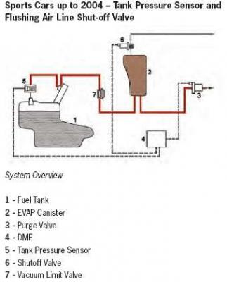

- References online indicate the simplified system for detection is as the attached. Where is the pressure sensor "5" located at? We've looked around the tank and the evac canister, doesn't appear to be anywhere near.

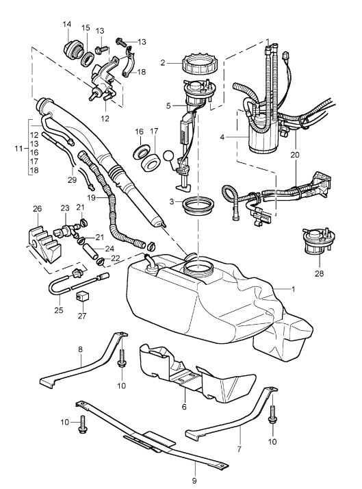

Originally Posted by TimAZ
- We need a full drawing of the tank vent system with the location of components
do you have the I.D. for the numbers?
Which numbers do you need?

I'm looking for the fuel tank pressure sensor...is that #23?
Where is the pressure sensor?

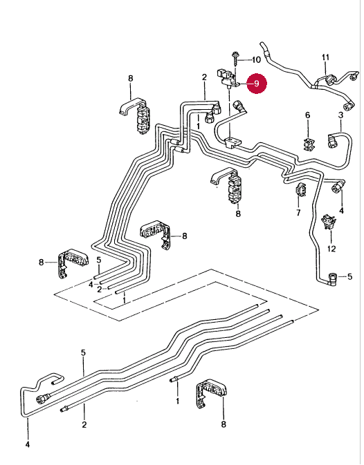

The fuel pressure sensor is #9 on this illustration.

Number #23 is a Fuel Tank Vapor Valve

Thank you, we've had a devil of a time finding this sensor's physical location, from the drawing it appears to be right by the charcoal canister. It didn't appear to be behind the wheel liner, is it buried up there under the car by the diff?
Are these drawings from the Porsche PET?
Here is the location.
Yep, all the illustrations are from PET

The picture seems to be pointing to "9" in your first illustration (below) this doesn't look like the sensor (pic of part on your website), is it just angle of view?

#9 in the first illustration is a fuel tank restraining strap.
#9 in the second illustration I posted is the fuel tank pressure sensor. Sorry if all this is getting confusing.

I meant "12" in the first drawing which I think is around the filler neck, your arrow is pointing in that area.
