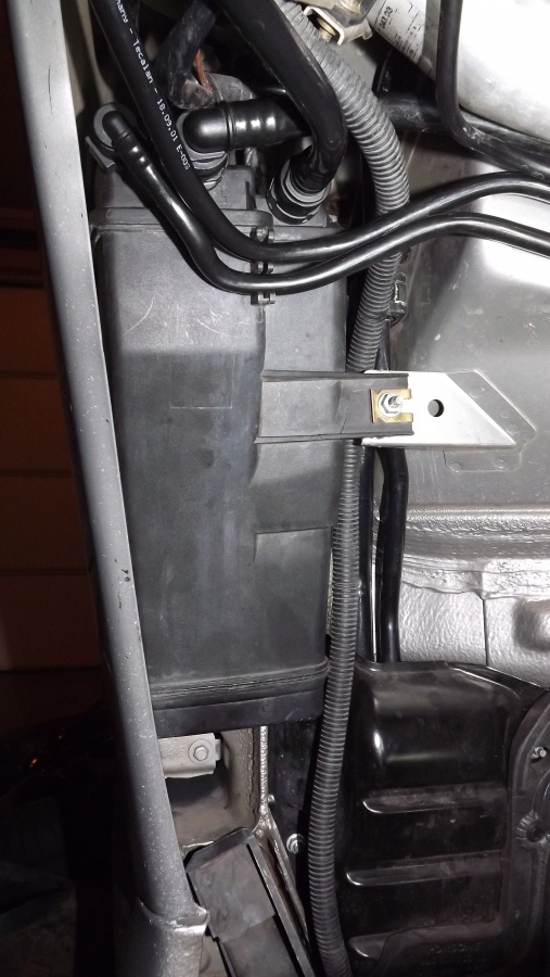

I have replaced one solenoid valve on the engine that controls the vacuum to the charcoal canister and the two valves in the manifold in the right front fender. I bought a Dura metric and can see the tank pressure difference is a positive when it should be a negative. A friend has brought his car over and I have been to his place comparing values from his car to mine. I have vacuum at the charcoal canister and the canister flows air threw all three pipes but I have pressure in the tank. My canister is different from the drawings in pep. I have attached a picture. Any help here??? Please. J

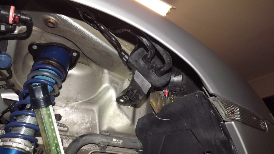

Another update...this seems never ending. I was using the Durametric with the car running watching the tank vacuum. In the attached picture you will see a blue (check?) valve to the left of the shock. I was snapping my finger on it and it would vibrate or kind of a shuttering sound and I would see the car try to pull a vacuum. Then is would stop in a second or two. Is this a check valve and does that seem to be a failure mode?
Tim
