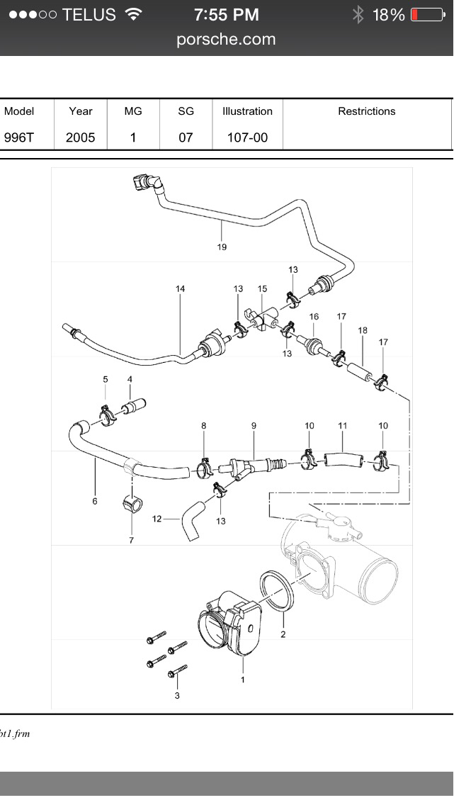

It could be your DV or Check Valve 16..
You can pull the air line by the passenger side turbo (intake side) and see if the air is coming from Check Valve 16. You can also take your MAF/Intake off and stick your hand in to see if you can feel air coming around the DV's and back into the intake at that location.

Just to clarify, I think he meant the air line on the inlet of the DRIVER side turbo, hose #19 which is connected to check valve 16. I'm not 100% sure but I think that and the DVs are the only 2 things that tie into your low pressure intake (air box to turbo inlets).
