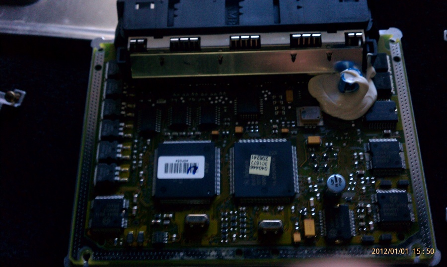

you can take out the ecu.. unscrew the top... look on the other side see if there has been any motherboard work.. thats old school but I have come across many of those... one can have someone readout the eprom and see if they program is stock..
but if the car is running .7 bar theres nothing more to discuss...

I guess saying it went back to stock settings would be more correct than saying lost the flash as APR is switchable. Of the tuners I contacted (renntech, giac, etc.) they all offered to look it up by vin.
I took mine to USP as they are an APR distributor and board sponsor. They had the car for 10 minutes and said they couldnt find anything. Would it be likely that if it was flashed back to stock it would rev to 7200rpm? I can watch my type 2 overrevs go up everytime I run to 7k.
Thanks for any advise you pros can offer
