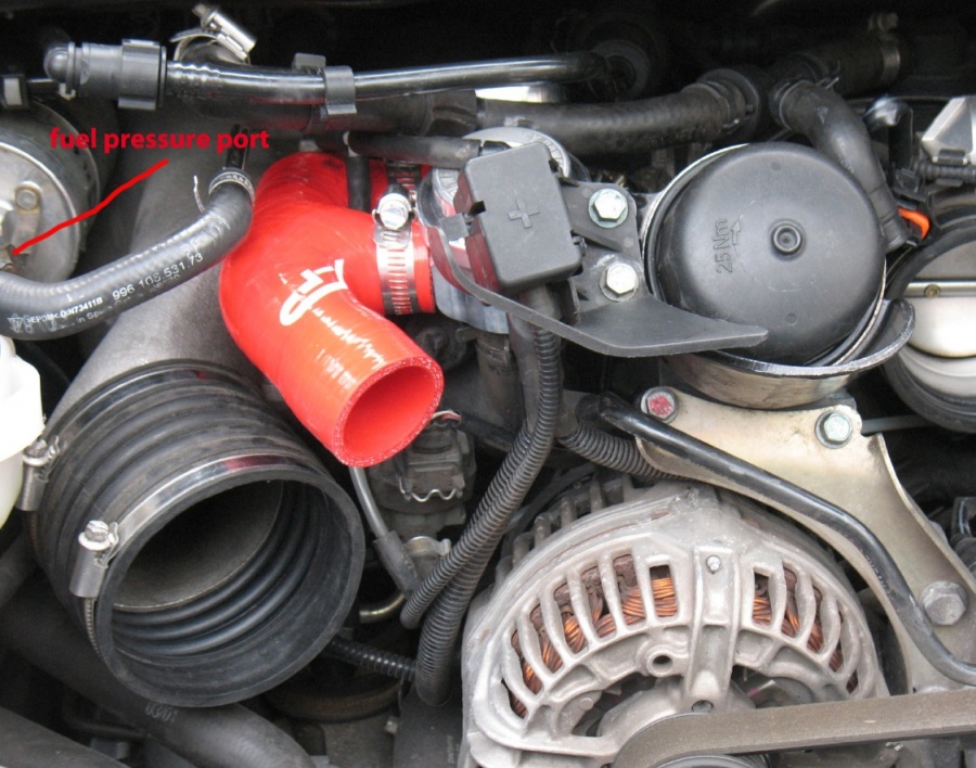

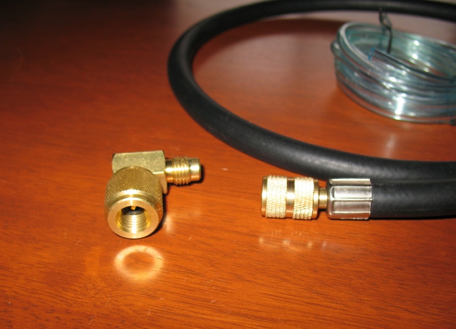

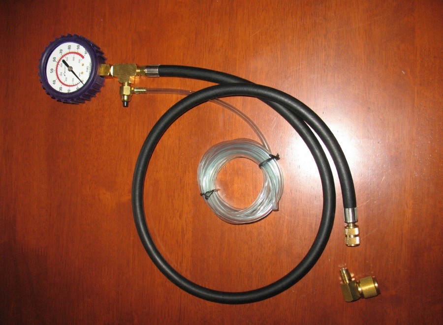

With pleasure Larry. First you have to get the gauge. The one I got is from Actron http://www.actron.com/product_detail.php?pid=16173. A good thing about this gauge, it got a relief valve and line to depressurized the system after the test and a line goes into a bucket to prevent splashing the engine compartment.
Also you need the proper adaptor which in our case is the "Right Angle Large Shrader Adapter part#0180-000-1299". The 90' adaptor is very useful for access.
You just plug this gauge to the port beside the fuel filter in the engine compartment. This port got a cap (13mm wrench) and under a pressure relief valve. That is why you need that special adaptor.
When everything is hook up you just put the ignition on (without starting) and you should get 3.8 bars or 55 pounds.
Porsche mention to also check at idle. In that case with the engine running at idle the pressure goes down to 3.3 bars or 47.3 pounds.
