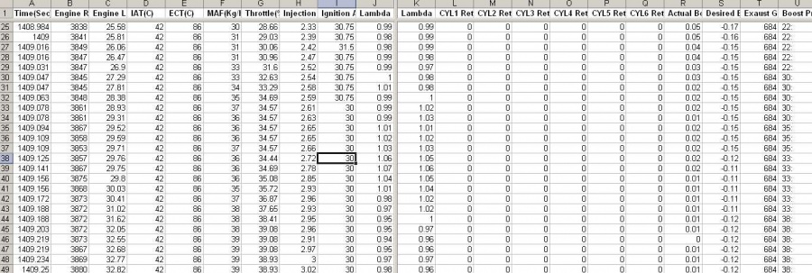

Here's a Durametric log with 126 samples/sec, maybe your computer needs upgrading.

Looks like an efficient tool but why does the log display identical times twice on multiple occasions? No concern about the accuracy of the data?

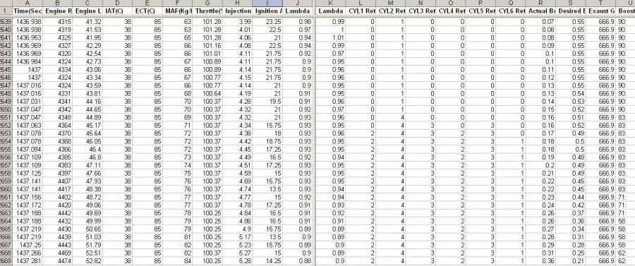

Here's another log showing some ret data; crappy AZ gas. UMW data logging tool.

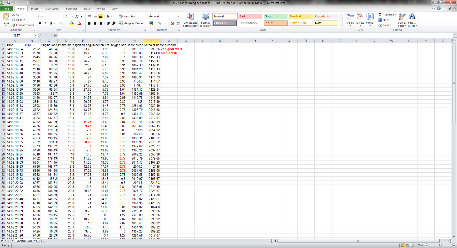

Would you guys be concerned with my datalog?
X50, 200cell Milltek exhaust, Forge actuators set to crack at 13.5psi, motorsport true 5bar FPR, US equivalent 93 fuel, EPL tune.
The red highlights timing pull & a bit of extra fuel, is this because of det/knock?

Looks pretty reasonable to me. You're correct - the timing pull and extra ful are there to prevent detonation. It's hard to get good data in 2nd gear because the time is so short. I try to do my pulls in 4th gear, but you have to have a place to do that.
