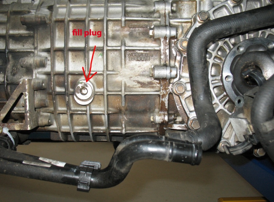

Is it possible you did not insert the allen wrench all the way into the plug's head and if you insert it all the way in you can get enough bite to remove the plug?
This is a rather common event with the Boxster engine oil drain plug -- I know we're talking about the Turbo and its transmission but they are similar in this regard, both using drain plugs (and the Turbo using a filler plug) with a allen head) as the allen wrench fit is quite good to the point one can encounter resistance which can fool one into thinking the bit is all the way in when it is not.
The drain plug might withstand this once or twice, but at some point the partially engaged wrench will 'strip' the flats and that's that.
I had a Boxster drain plug goofed up by a quickie lube place. The next time I took the car to the dealer the tech found this and managed to get the drain plug out out by tapping in the wrench bit to force it past the stripped out burr to the point the wrench bottomed in the hole.
Thankfully the bit held as the tech removed the drain plug but the tech had a heck of a time separating the wrench bit from the drain plug's hole. I was so happy he managed to get the thing out I would have bought him a new wrench bit. I did buy 2 new drain plugs (he loaned me an old one from his tool box) and gave him a new one to replace the one he loaned me. The old one went into the console as a spare and the new one went into the drain plug hole.
Anyhow, or is the thing truly stripped?
If it is stripped, you are looking at -- or having it done -- drilling the fill plug out enough you can remove the cored out plug with an easy out.
With the right drill and drill motor and slow speed and heavy grease this will entrap any drill chips and keep most if not all of it out of the tranny.
If you want to be real safe, enlist a helper with a shop vac to vacuum any drill chips away as you drill.
Of course you'll have to buy a new fill plug.
BTW, are you sure the drain and refill plugs use an allen wrench or do they require some other form factor wrench, like a torx?
I might have pics of my Turbo's tranny and the drain plug form factor might be visible. I'll check...

Allen, not torx. I have a pic of the drain plug of my Turbo's (old) transmission (just before it was replaced under warranty) and the drain plug is an Allen type. Almost certainly the filler plug is too.

It is 10 mm allen and the torque is 22 ft/lb for the fill and drain plugs. Be careful if you try to drill this plug. Did you used a very good quality allen wrench? Stay away from cheap ones.... Sorry but I don't see how you can completely damage this plug...

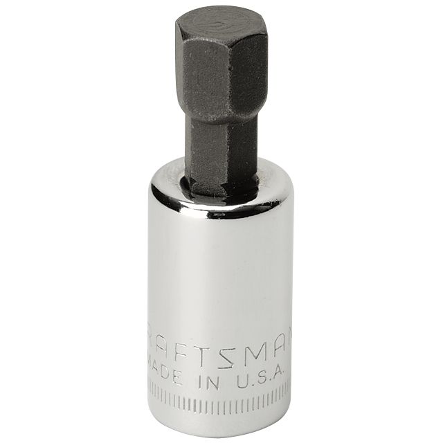

I use a hammer and one of these:
Just hammer it in - it helps relieve your frustration. Craftsman makes them, but so do several other companies - they come in various sizes depending on the bolt. It's designed to penetrate and cut the bolt, grab the corners, allowing you to grip and twist the bolt out. You obviously will have to replace the bolt. And unlike a chisel, it grips all four corners for something that was over torqued. Just use an open wrench or a vise grip and twist the bolt out. Since encountering my first stripped bolt, it has saved me countless frustrating hours over the years.
Often times, a recessed Allen insert is actually a Torx insert, or vise versa. I know other members have already stated it's an Allen. Just saying...using a Torx when you should have used an Allen is a sure fire way to strip the bolt, especially a soft aluminum one. When the bolt is out, replace it with a stainless steel one or a quick drain (depending on how often you change the fluid.) I have changed my engine oil plug on my Cayenne to one of these:

bbywu, I will buy one and bring it to my mechanic if he wants to use it. It's MUCH more comfortable to work using a hydraulic lift. Plus I rather not screw up again because if I do it means very big trouble...
