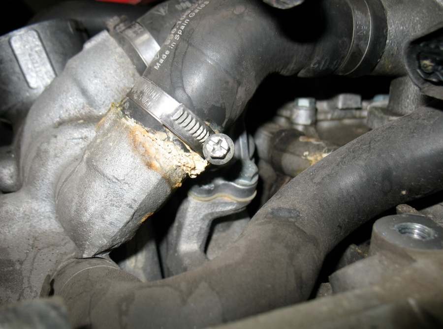

Since 2008 my car was consuming coolant and finally this winter I've decided to look for it...First got the oil analyzed by Blackstone, no coolant present. Did a pressure test and I had a drop of 1 pound per hour and no visible coolant leak….After I got the engine running at idle until the normal temperature was reached and stop it and start dismantling the filter housing and after the intake assembly. I've found one of the pipe coming from the water pump housing was leaking because the glue was not holding it anymore. The pipe could not go out due to the tight space and short rubber pipe attach to it. There was no leak on the ground but the coolant was just staying on top of the engine and eventually evaporate due heat (the leak was small). Picture is with the alternator removed and the generator bracket removed.... Finally got the engine out and all the 8 pipes welded....

I forgot to mention that you could also add dye to the cooling system and use an inferred light to find small leaks. To jpflips point you should pressure test while it it hot or even running. Pressure testing while running is also a good way to test for head gaskets. You can really see the white smoke out the tailpipe while hot and under pressure.
