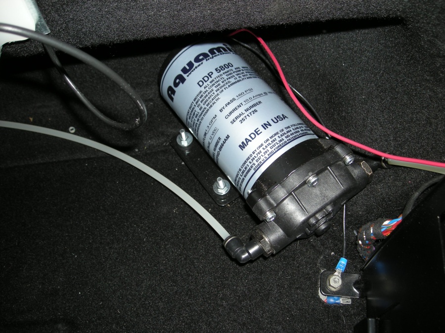

I ran the plastic tune under the car in drier side. I used a thick fuel hose on the outside to protect it from kinks or punctures. And I agree with above post - Aquamist is the way to go !

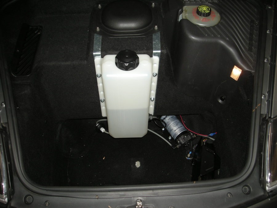

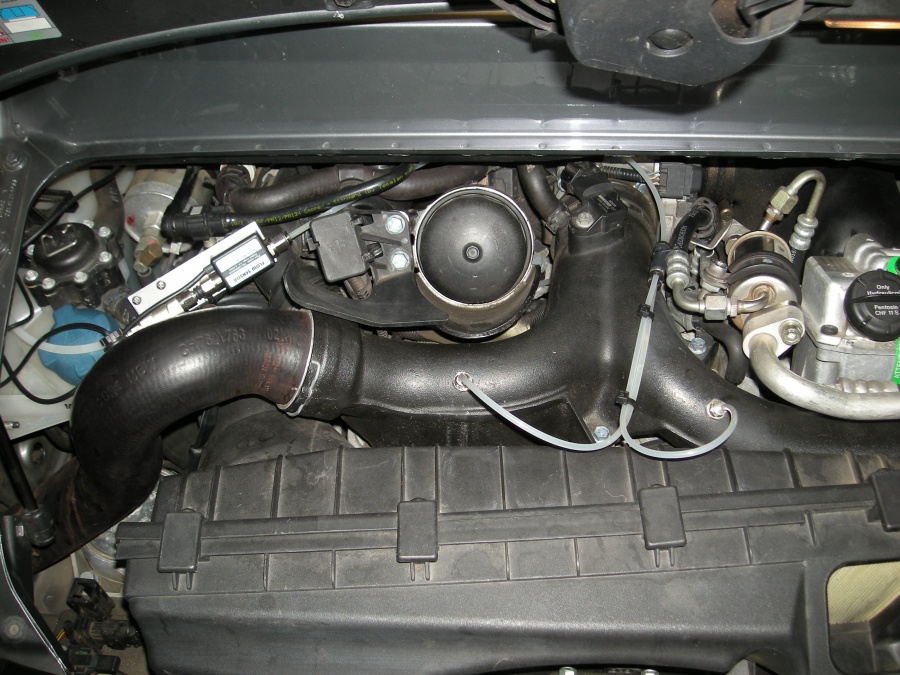

driver side fednerwell, under the car, then bring it on top of the driver side intercooler and route it in through an existing opening there.

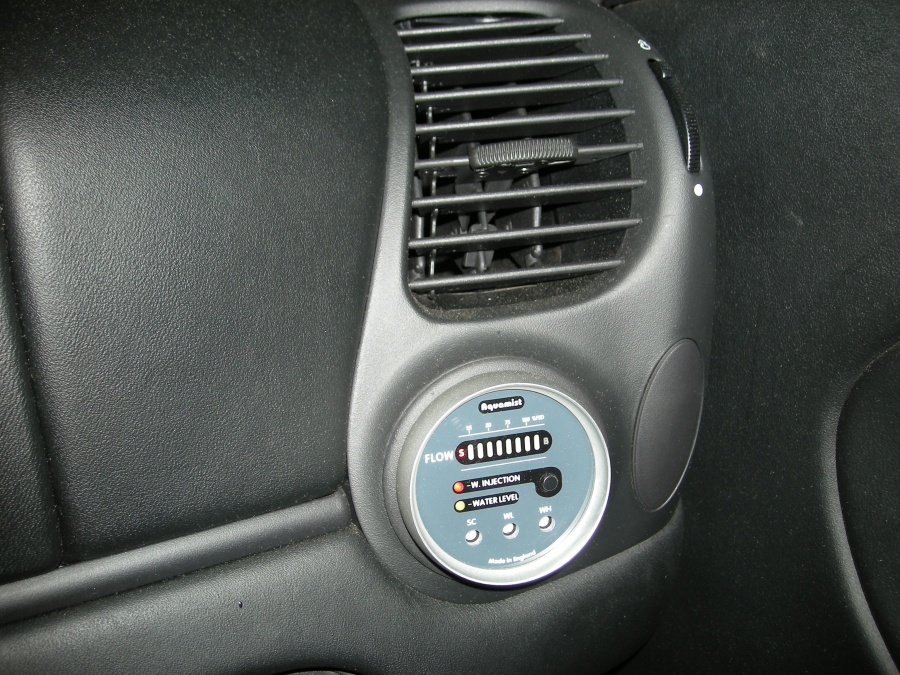

This is how I did mine. HIGHLY recommend the Aquamist kit. 6qt tank and pump in front boot, everything else out back. Controller in ECU tray. Gauge in interior sensor location. Fits almost perfect.
