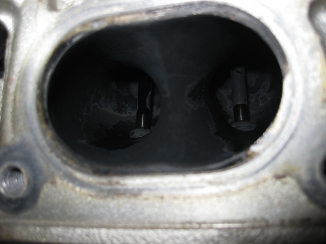

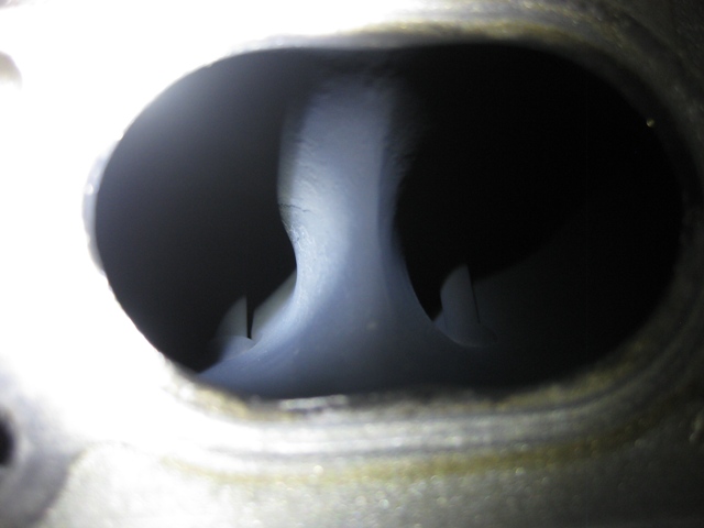

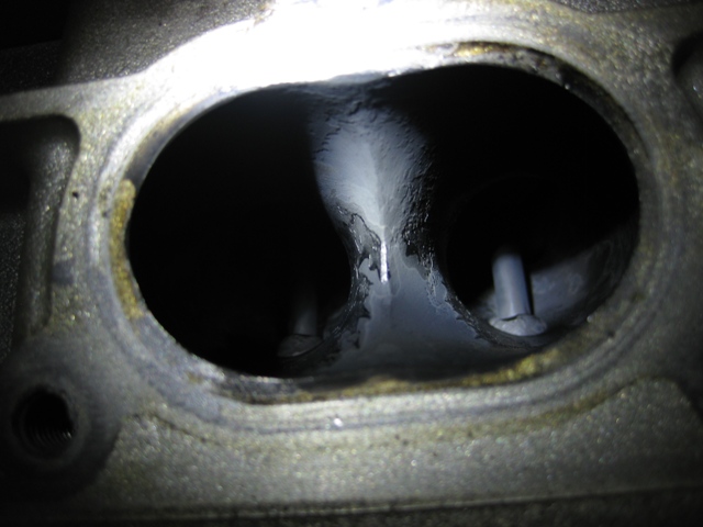

exhaust and intake timing were good
the problem is in the pics below...oil coming from cylinders 3&4
there appears to be oil in the exhaust port and oil around the valve heads
damn that sucks, was your motor built ? is it stock ?

i am not sure if this shows what is causing the power loss, but i think it shows what is causing the smoking
i just don't understand how my leakdown and compression were good if two cylinders are messed up?

recently build 3.8 engine...my builder is out of state and does not get along with my mechanic...this is not fun
Ben,
Leak down is done on bottom dead center. If there is sleeve damage anywhere above that spot it will not show on a leak down. Bad news is you need to pull off that head and remove the jug and see with your eyes whats going on.
