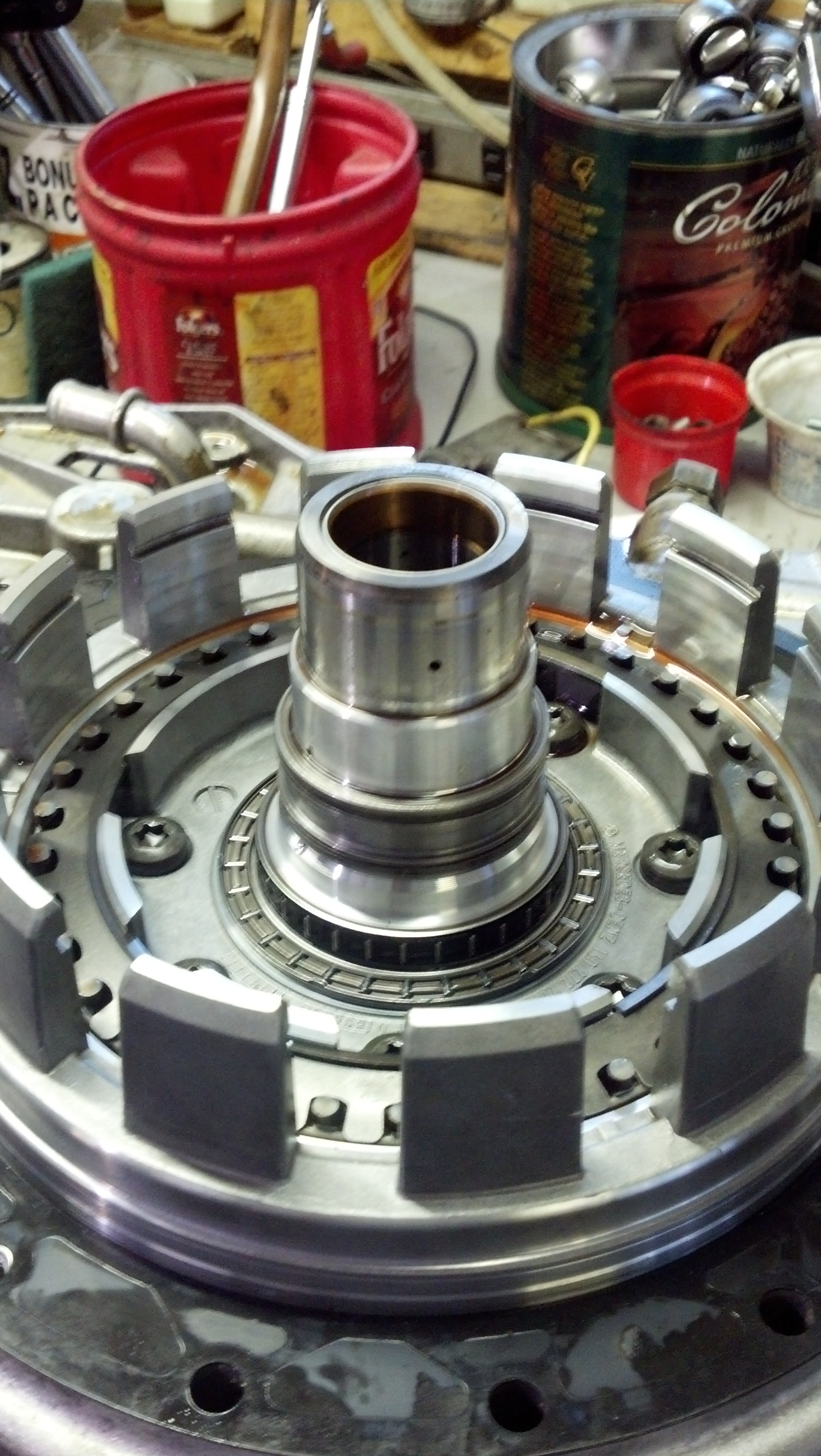

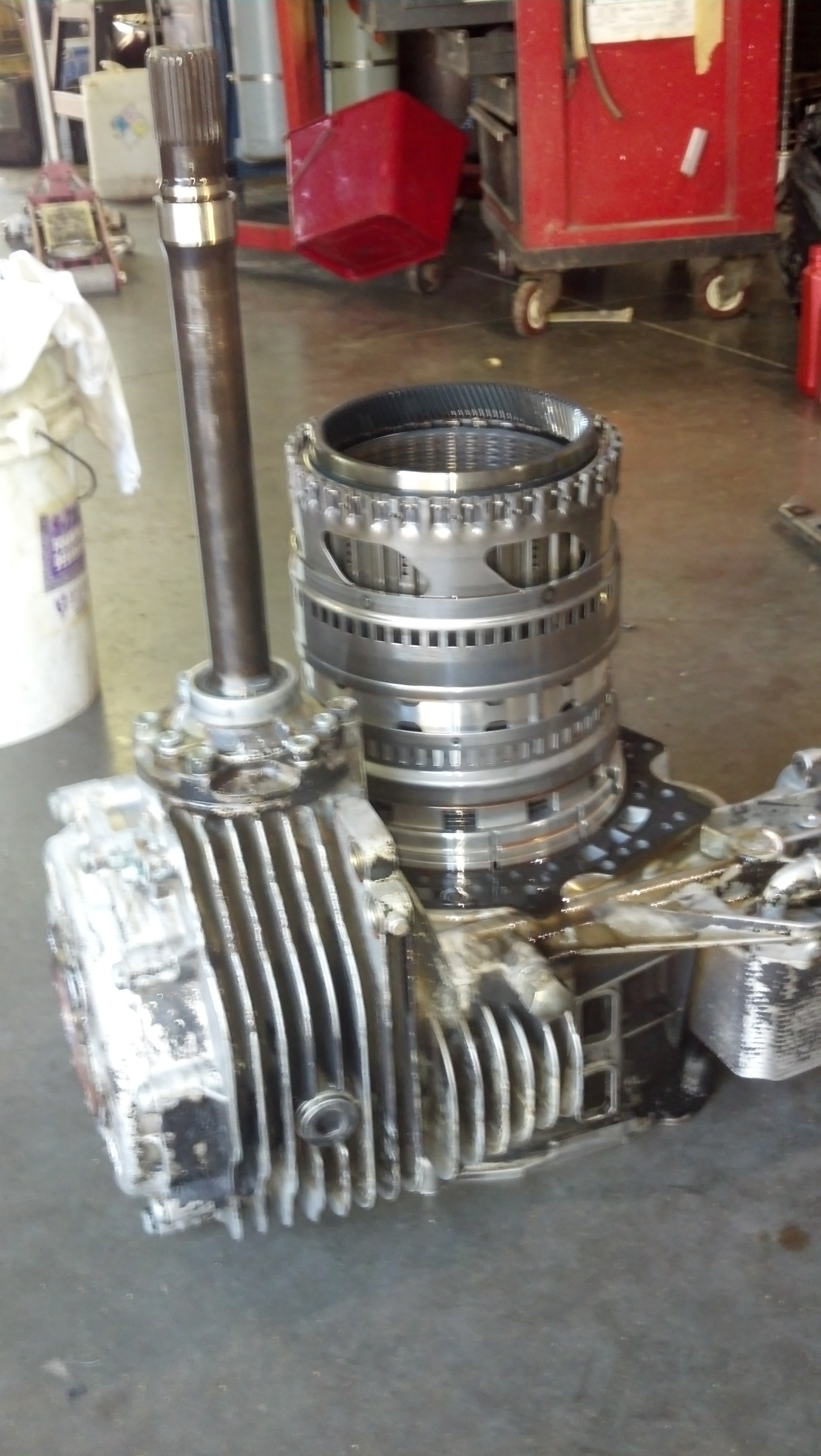

  #58
pat's Avatar
pat
Joined: Dec 2009
Posts: 875
From: indiana
Rep Power: 80
pat has a reputation beyond reputepat has a reputation beyond reputepat has a reputation beyond reputepat has a reputation beyond reputepat has a reputation beyond reputepat has a reputation beyond reputepat has a reputation beyond reputepat has a reputation beyond reputepat has a reputation beyond reputepat has a reputation beyond reputepat has a reputation beyond repute
some pictures
ID:	272916   Click image for larger version
ID:	272918   Click image for larger version
