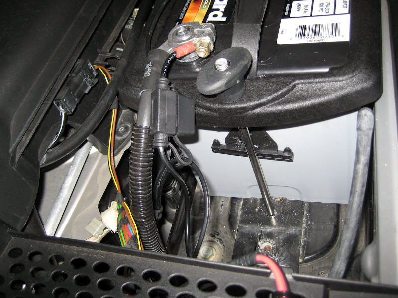

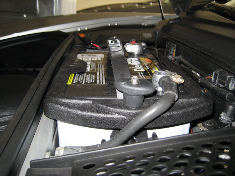

I found a "boat"
mount that is a temporary solution:
I used the top plastic hold down, cut down the rods to fit under the hood, and re-threaded them so they would thread directly into the OEM tray. If I had a welder, I would have welded them in place, but I used Loctite yesterday. I wouldn't race or do any driving events with this, and I'll keep an eye on it until the GMG tray comes in, but it's in there pretty solid.

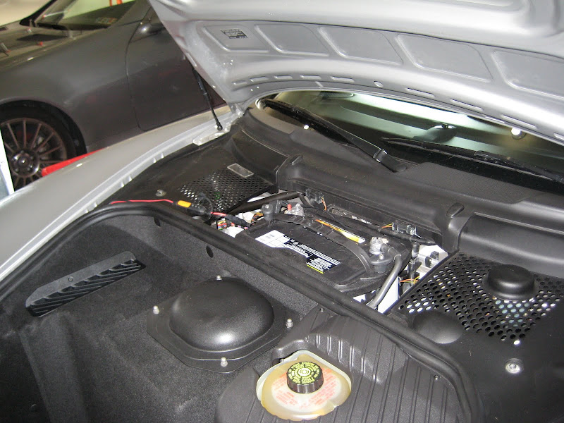

This weekend, I figured I better mount the thing somehow or I won't be driving a 911 this summer. Lesson learned: there's lots of mounts boxes, trays, hold downs, etc for the curved Optima shape, but not the box shape of a normal 34R.
I found a "boat"
mount that is a temporary solution:I used the top plastic hold down, cut down the rods to fit under the hood, and re-threaded them so they would thread directly into the OEM tray. If I had a welder, I would have welded them in place, but I used Loctite yesterday. I wouldn't race or do any driving events with this, and I'll keep an eye on it until the GMG tray comes in, but it's in there pretty solid.
