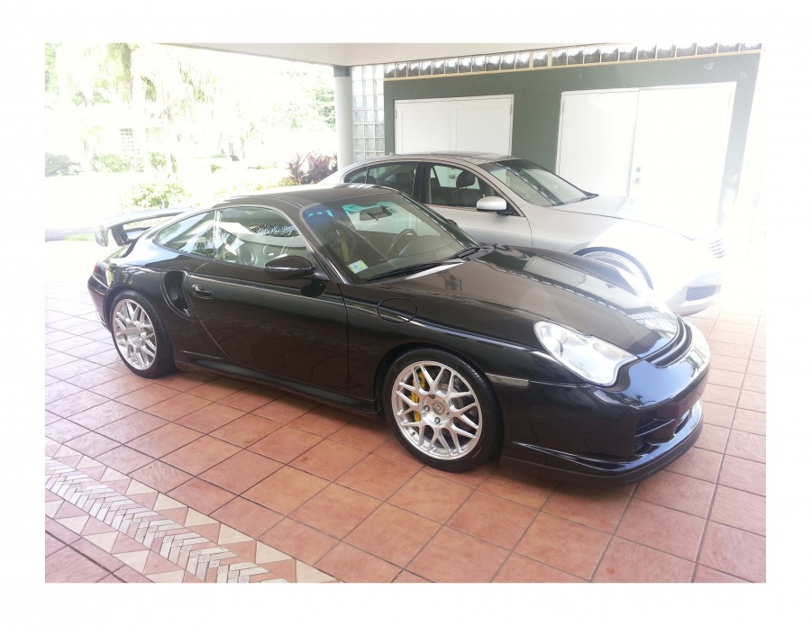

Old 10-04-2012, 09:29 PM
gclasse's Avatar
Join Date: Dec 2011
Location: Puerto Rico
Posts: 374
Rep Power: 62
gclasse has a reputation beyond reputegclasse has a reputation beyond reputegclasse has a reputation beyond reputegclasse has a reputation beyond reputegclasse has a reputation beyond reputegclasse has a reputation beyond reputegclasse has a reputation beyond reputegclasse has a reputation beyond reputegclasse has a reputation beyond reputegclasse has a reputation beyond reputegclasse has a reputation beyond repute
Hre

Originally Posted by gclasse
Looks great!
I've really narrowed it down to three wheels to choose from. All are very similar. The HRE p44SC, HRE P43S, or Forgestar CF10. It's really hard to tell the difference between the HRE P43S and Forgestar CF10. Do you have any recommendations on quality between the two brands? They both seem good.
