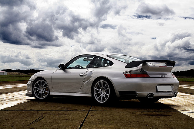

So, I've spent the last 3 hours looking through threads, but none seem to answer this question completely. I think this is primarily a result of making different size tires fit the GT2, which has 18x8.5 (40 offset) and 18x12 (45 offset) on the OEM wheels in addition to the relatively low production numbers of the vehicle.
In your opinion(s) what wheels look the best on the 996 GT2 and how do you make them fit properly if they aren't the OEM spec listed above?
Bring it! Pictures, and comments much appreciated.

Personally I'm a big fan of HRE and BBS. Both are very lightweight and strong. HRE offers a bunch of different styles that will fit the GT2. Some 7 mm spacers front and 15-18 mm rear will help a lot of them fit more flush in the fender wells.
The key question here is what's your budget? And are you looking for something as lightweight as possible, or is style the major goal?
If you want performance then 18" wheels are the obvious choice, but 19" wheels look better appearance-wise.

i run the f14 in brushed silver: 9x12x18 with 40mm offset front and rear. it's pretty aggressive stance at gt2 height, and looks and rides great. fully flush at the fenders without spacers. the good news for you is they make that wheel in a hubcentric fitment in 19's. i wouldn't go that route myself, since i think the 18's are better suited to the car. but 18's regardless of offset still require the insert ring. best bang for the buck and they are made well.

sting thoughts on the 19" wheel. 315 rubber will get harder and harder to find. i ordered mine in 18" that being said when i get my wheels i will have a decent set of hre wheels with michelin rubber that im going to sell.

Good thought on the 315s. Will the 325s not fit in the 996 GT2 wheel well?
