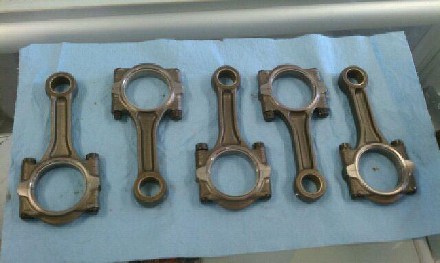

Mark we could have made torque sooner. Remember I had 5857's... You on the other hand wanted 800+rwtq at 3500 RPM. Which is stupid. I also beat the **** out of my car more than most people in this thread. You would laugh at how many times I would go and try different methods. Probably 3k of the 6k miles on that setup were on MS109 if not more. I may have some of my receipts still if you would like to see. I also ran it for over a year FYI.
About a month before the motor coming out when i destroyed 3rd gear we made 840rwhp in 90-95* weather (we went out on the lake right after) on 26psi. During that month I had a BAD BAD BAD tank of gas that I limped the car around on, second tank didn't help, then added some 104oct and pinging was gone. Next day I blew up third.
Motor came out with 4 bent rods and 2 slightly slightly bent, but engine builders quote "there are no score marks or sign this is new, they look like they have been for a LONG time". I've talked to other companies who have witnessed the same thing (car makes power right before motor comes out and rods are bent).

Here is what my rods looked like after 700hp/tq power levels lined up straight on a bridgeport. few were a few mm off.... others dead straight..
There was absolutely no damage to the cylinder walls or anything else. Fact is that these rods are not strong enough for big power and will eventually give out you and i knew we were going to open our motrs up and put rods in them.
For people that do not want, do not plan, do not/can not spend the money to crack the motor open and fix/upgrade parts - I never recommend running over the 700/700 numbers on good gas. Above that its a different level of modifying.
Im sure when you saw your rods you realized that your motor was a ticking time bomb with a lot less left on the timer then I had on mine when I took them out

I only have one half *** pic of mine, but you should be able to tell which are the bad ones. Yes one was missing at the time of the pic
Like I said I don't recommend this to anyone. I never rush things and I try and buy the best as much as I can. I've made a lot of dumb decisions on this car. After this race and I send off my Tilton for new disc's my new intake will be slapped on. I'm making sure its done all pimped out like.
