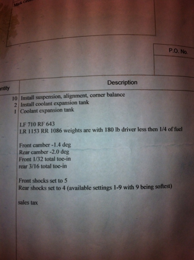

I also have PSS9 with TRG droplinks and have a street/track setup and actually going in for a few tweaks in the next few weeks but it has worked very well for me. I did stiffen up the PSS9s a notches.
