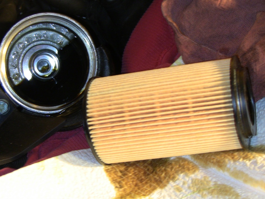

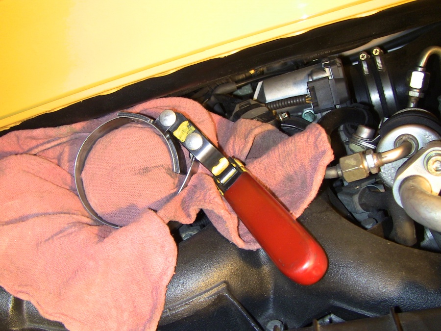

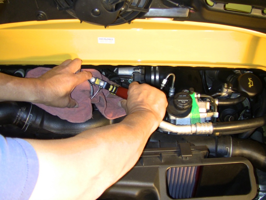

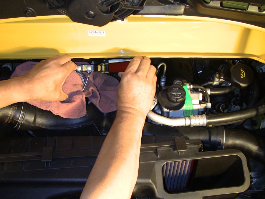

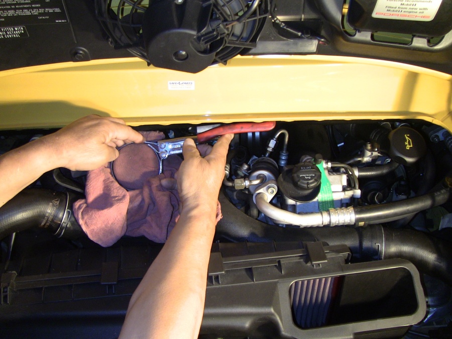

I have an O2 Turbo and changed my oil 3 months ago.
I tried all the Autozone wrenches and couldn't find one that works. My mechanic friend showed me how to get it off in less than a minute with the Lisle Swivel Oil Filter Wrench #LIS53700. See attached pixs. You need a swivel handle wrench to get a full swing and clear obsticles. I bought it online for less than $9. I posted it to a Oil Change DIY but can't remember which one.
I did drain the Turbos this time but will not the next. I measured the oil from both turbos and it was less than what would fill a Jello pudding cup. There is probably more residual oil left in the bottom of the crankcase than what is in both turbos put together. As some folks have said, the new 997s don't even have drains on the turbos for draining.
As for suctioning the remaining oil in the filter canister, use a cotton rag, old cotton T-shirt, and soak it out. I'd tried several in-expensive suction and none of those worked. I believe the DIY that suggested a hyperdemic needle may work. Anyway, by the picture attached, there's less than 1/2 of a Jello pudding cups worth there as well. The total is far less than the 9 quarts you are draining out of the oil tank. BTW, use at least a 10 quart pan for the tank drain.
Also, very little oil comes out of the crankcase, since it's dry sump.
As for jacking up the car, the back is good enough, but jacking on all 4 corners will make the car level. Maybe a little more oil out of the crankcase, but not much since it's mostly in the oil tank.
I hope this helps.

I'm glad you can buy the wrench in Canada for $20. The vendor sponsor on this site sells it for $39.95. The other Porsche Dealership in my area(also a vendor sponsor) says they don't sell one. Another online site sells it for $44.95. Also you need the 25mm wrench to use the filter wrench, another added expense.
I use a rag (as shown on the picture) and have never scratched my filter cartridge.
