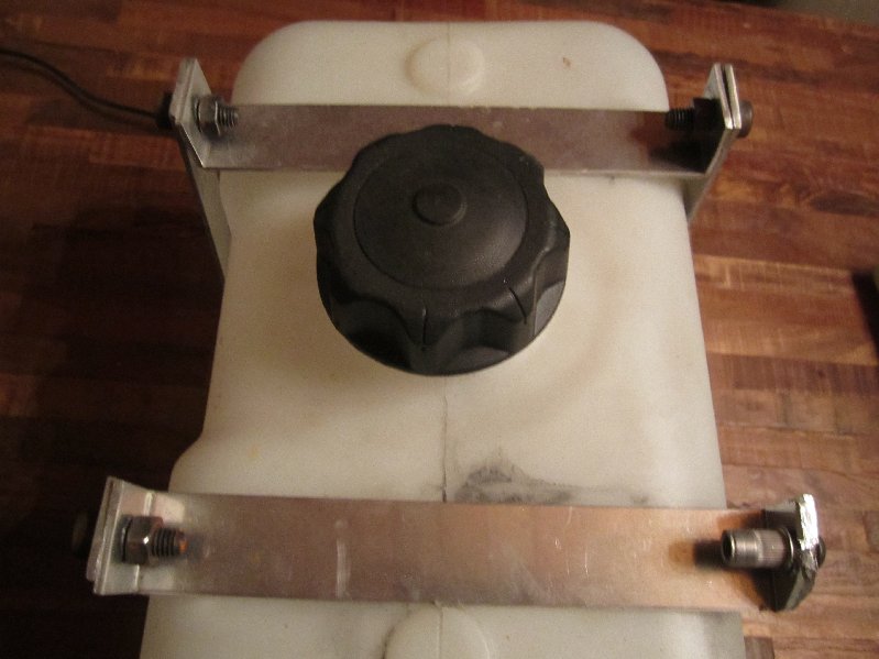

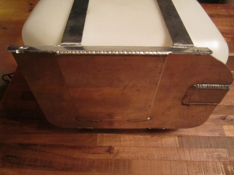

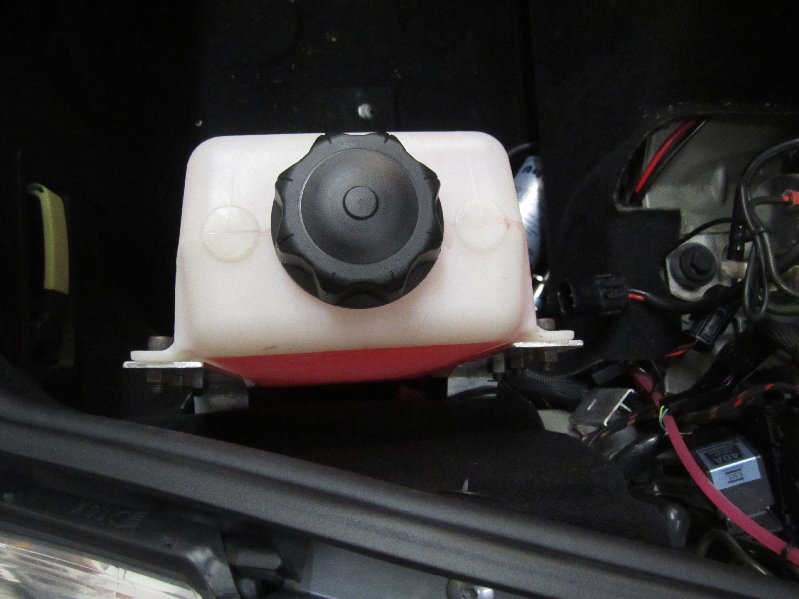

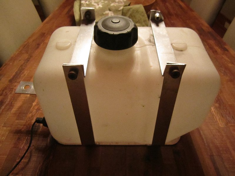

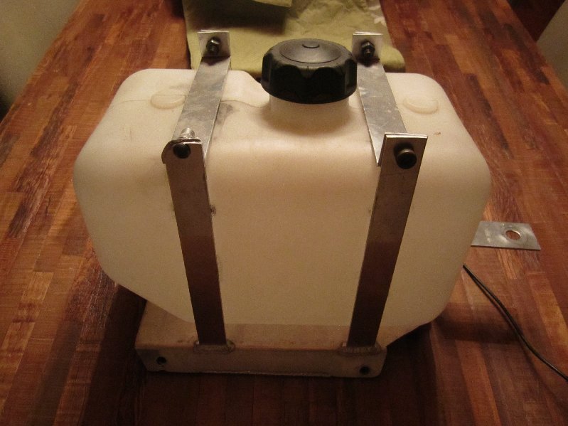

Pics of my installs
Several people have inquired about my tank installs and Tony posted a pic of my current tank setup 6+1. Here are a few more pictures of both the 2.5 gallon tank with custom bracket and the 6+1.
EPL did all the work, including hooking me up with a local tig welder who made the bracket. They did a great job as usual.
Both tanks attach to the car on the rails you can see in the pics on the drivers side trunk wall. The 2.5 gallon tank also attaches to a factory bolt on rear trunk wall (you can see the tab in the pictures).
Sorry, I don't have any pictures of the 2.5 mounted in the car.
