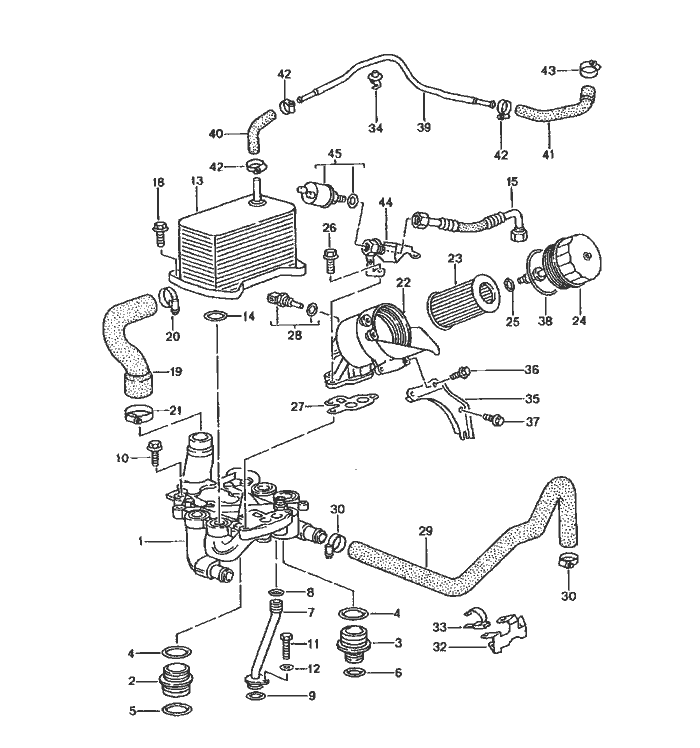

Hi Basic, good to hear you stopped yours smoking, what was the breather you referenced?
"which turned out to be the manifold on the top of the case for the vent/breathing to the oil tank"
Where it seals to the two case halves its just a thin flat surface, likely a common leak point on all of these cars.

I may seem slow but what part number in the diagram, you mean 1, am assuming that bolts to the block and they sealed that mating surface?
Still getting familiar with this engine

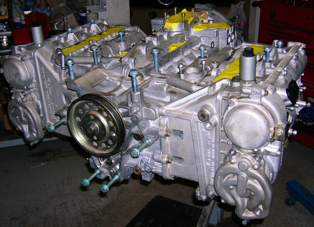

Exactly, here's a better picture, it's at the top where the 4 bolts are. Just a thin flat mating surface which had a light coating of sealant which had gone away...I used motogrey silicon which is a motorcycle thin silicon for these types of surfaces.

great thanks for the pic, did they take the engine out or was done with the engine in?
How come there is no light weight under drive pulley on there? LOL
I did the work with the engine in the car, stripped off all the coolant manifolds to weld them. Also replaced all of the rubber hoses and o-rings/seals. Not the easiest thing to do in the car but at the time I had no room to pull the drivetrain. After doing it I wouldn't pull the engine to do this work, not that hard just tight in a few spots.

mikes996turbo is just really nicemikes996turbo is just really nicemikes996turbo is just really nicemikes996turbo is just really nicemikes996turbo is just really nice
shame we did not have this exchange before, I did the same pulled the top off the engine to do the water pipe pinning, managed to do all of the pipes engine in, as you say very tight but doable - thanks once again
