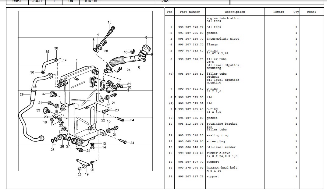

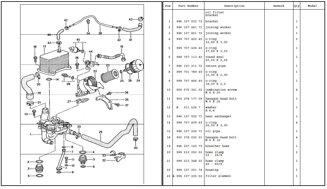

what your mechanic is suggesting is correct when sitting for a long time(ie. winter storage) and is related to what I had suggested with the tank draining into the crankcase, but is happening much quicker than proper. If he is suggesting some oil gets flung off the crankshaft, etc. then that could, and does happen the odd time too
Have attached a couple pics of the oil 'sytem'
ID:	276875   Click image for larger version
