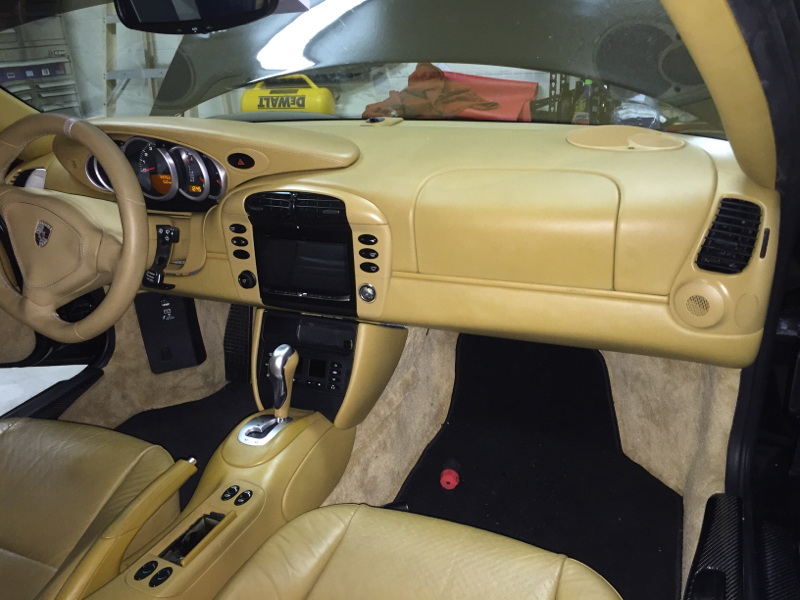

Old Oct 16, 2014 | 05:43 PM
  #58
Vantaredoc's Avatar
Joined: Nov 2013
Posts: 1,052
Rep Power: 154
Vantaredoc Is a GOD !Vantaredoc Is a GOD !Vantaredoc Is a GOD !Vantaredoc Is a GOD !Vantaredoc Is a GOD !Vantaredoc Is a GOD !Vantaredoc Is a GOD !Vantaredoc Is a GOD !Vantaredoc Is a GOD !Vantaredoc Is a GOD !Vantaredoc Is a GOD !
Going back together! I haven't had much spare time lately. I'm sure ready to "feel the thrill" again...lol

Old Oct 18, 2014 | 08:02 AM
  #59
Vantaredoc's Avatar
Joined: Nov 2013
Posts: 1,052
Rep Power: 154
It lives! Nice to be back on the road! A/c works great, no foam, no rattles and squeaks! The best part...I seem to have fixed the rattle I had going over certain bumps! This rattle has been driving me crazy! Turns out it was the heat blend door due to all the foam that came off. I forgot the feel of acceleration sensation! Crisp 68 degrees this morning and a smile on my face
