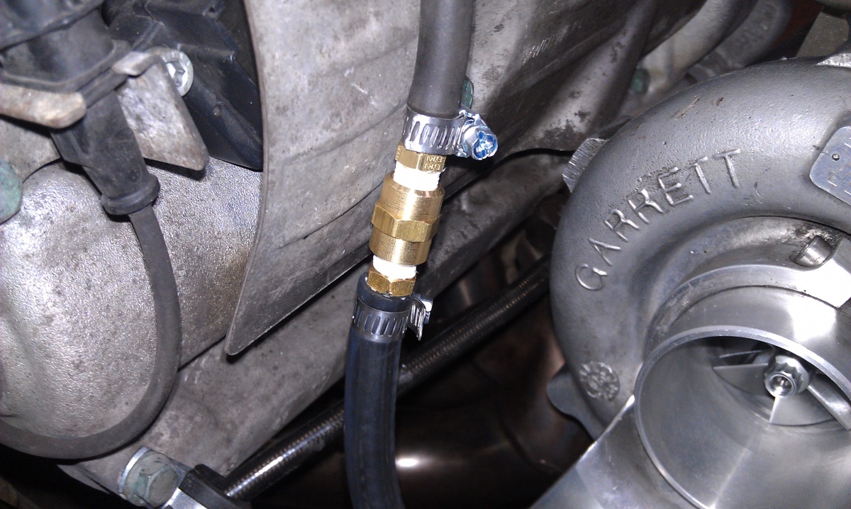

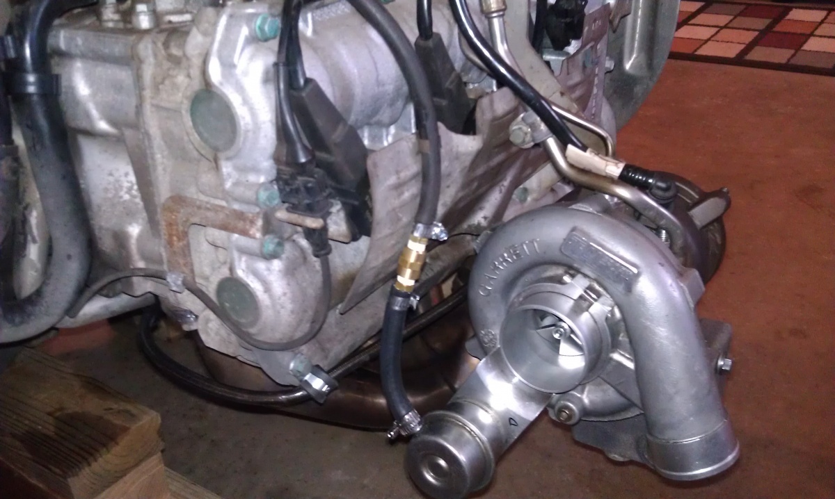

I used brass as well. Just go to NAPA and get the brass fittings and make a 1/8 to 3/16 adapter. your stock hose will not fit over the upgraded WG

like this

Originally Posted by TurboTodd
like this
What kind of hose is that small extension and how is it holding up? I don't want to be the dumb !#%* who blew it by using bad hose! I picked up some fuel line so I think it should work.

Standard fuel line will work fine as it is rated for pressure as opposed to vacuum line.
