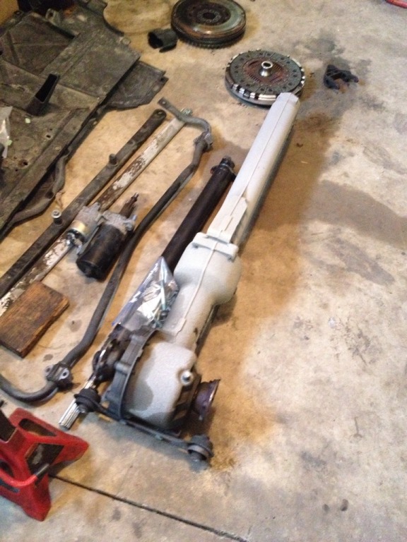

Originally Posted by ttboost
Both. Save about 70lbs with a full conversion, and you get that GT2 feeling...
My car felt much faster with the RWD conversion, and quite frankly was useless as an AWD vehicle. Some just drop the front axles, which is kind of useless. The right way is to remove axles and front differential.
Definitely remove the differential. It is a good amount of weight when you consider the driveshaft and torque tube that go with it....

Originally Posted by HIX
My front diff makes a 'whine' that has driven me nuts since I bought the car. I'm wondering if this might be a good way to take care of that. I just don't want to lose performance if it's better AWD.
The good thing here is that if you don't like it, you can always go back provided you save everything and don't destroy the axles.
I hear you. Quite honestly, I bought the 996 Turbo because it was AWD. After some seat time, I realized it was all hype. I dumped the AWD and went FULL RWD. Car was WAY more fun. I did a lot of additional weight loss mods to the tune of 250lbs, so it was very noticeable mod. It's really only about an hour job if you are handy with a wrench. Maybe a little longer if you don't have acces to a lift.

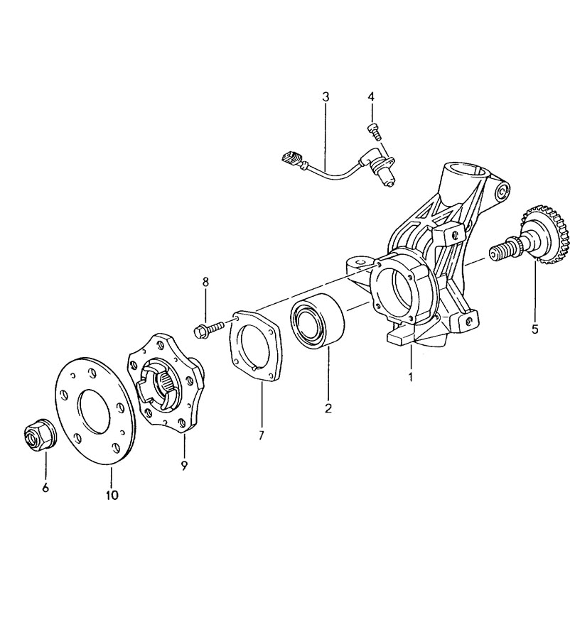

Originally Posted by PL2
Hi,
I just don't understand why everybody is going to the trouble of destroying good axles.
You can replace the stub AKA "Tension bolt" with the 2WD part from the GT2 or 996.
Part # 99634113190 #5 in picture below.
Wrong. The GT2 stub axle will not fit the TT. Been there, done that.....
