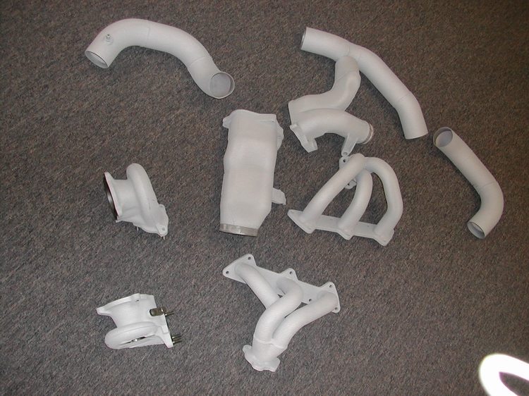

Stephen and I decided to have my headers, turbine housings, and EVO aluminum intake manifold coated with Swain's white lightning coating. The coating looks great and should be very effective in keeping the heat inside the exhaust and out of the intake plumbing.
