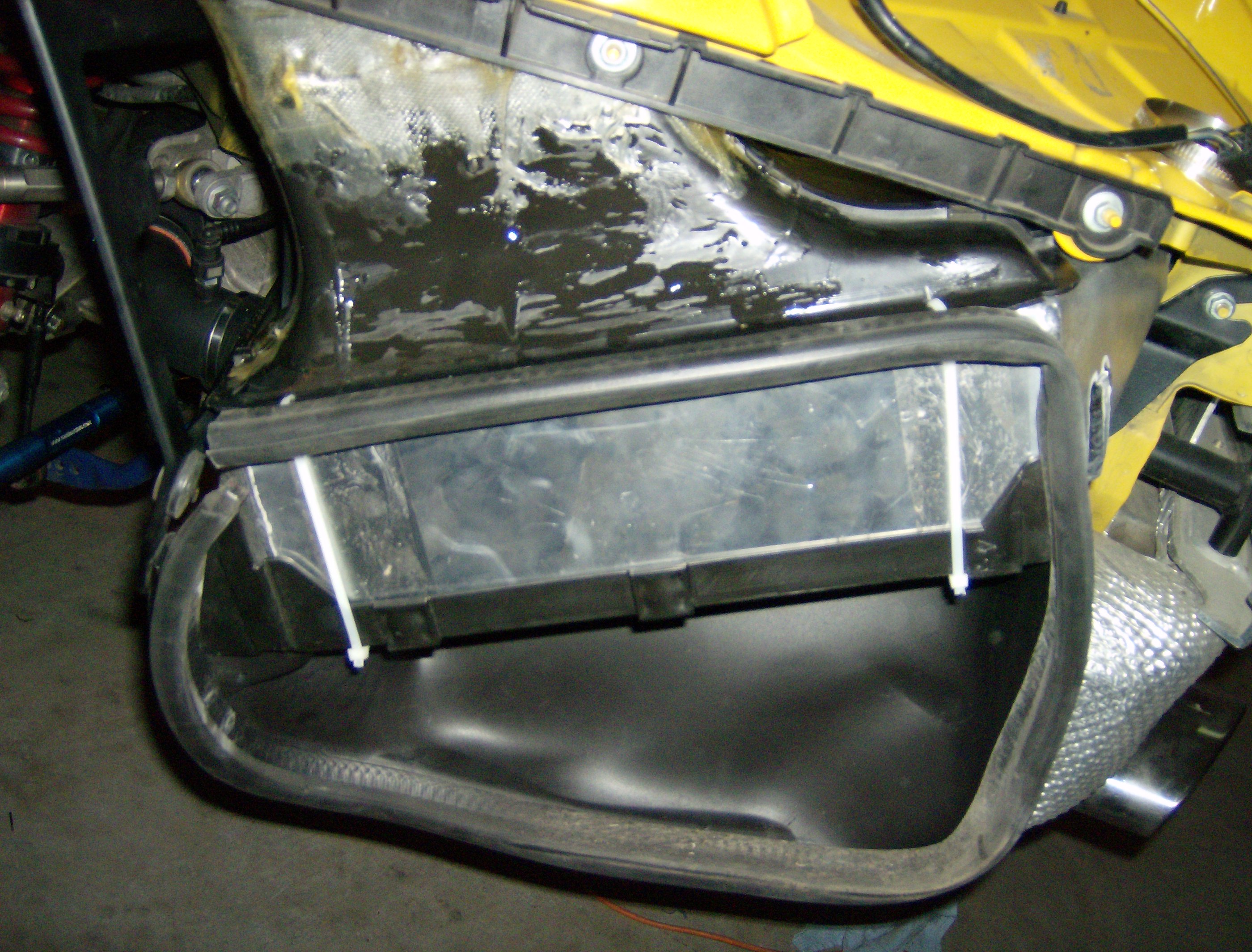

Clearly my arts and crafts skills suck! Cut the first duct and it's obvious a sawzall is a poor tool for this even with a fine tooth. A rotary cutoff tool would likely be a far better choice. I'm going to attempt to fit the duct and measure, a fiberglass bandaid may save this job. Slipping one duct half inside the other is also proving a little tough although the bottom duct splits open a bit to allow it. Test fitting for height will happen after I get some hardware, probably pickup some fiberglass too. Once the trial run on the passenger side is done I'll disassemble the driver's side and do it over again lol! Gotta' run wiring for the temp sensors on this side too...

i just used a hacksaw blade with the end wrapped in duct tape for a handle.

Power tool was a poor choice, lesson learned! I'll see how this goes and cut the second one for this side if I must. I think I can salvage this but the other side has no backup so I'll have to be doubly careful.

anything you cut can be repaired with fiberglass. stick it inside and get your height. glass it as thick as needed and install it. once the bumper is on you never see it. heres mine. didn't care what it looked like as long as it fits and it does.

Agree! I've not gotten back to it yet but I'll get it set right and glass it well. I can make it pretty afterwards. Fabrication is obviously not my strong suit so this will be interesting. If I can get it mocked and marked it'll come out fine. There's something to be said for Mark's service of cutting ducts!

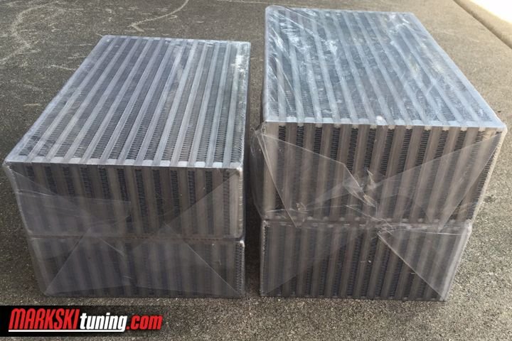

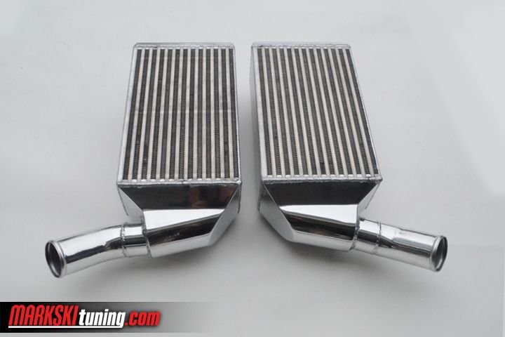

heres what I do... the 3.5s I make ran a sub 6 second 60 to 130s on a k16 billet car and a low 5 second on a A28s. The 4.5" I make made over 1000 HP on cars in Texas as well as 1200 whp on a 997 in Kuwait... I have been using these and doing pretty well at the 1/4 mile strip as well One of my german clients with a 3.8 L on A 28s at high boost on the autobahn is very happy on the top end ... logs galore..
just sharing... and back in the early 2000s when most were just throwing X 50 ICs on I was on the ground playing around with my 4.5" cores... core quality, fabrication, end tan design and flange cnc precision is the key...

RS are lighter no doubt and no AM can even come close. I think the benefits of quality ICs outweighs the weight disadvantage. Mind you, my 996 now had 6" monster ics, heady hta 3582s with heavy 44 mm wgs and headers. I still do pretty well at the track
You pick and choose I guess. Some guys throw on heavy 19" rims and tires and kill the power and or traction etc. but added light weight seats. It is what it is.
