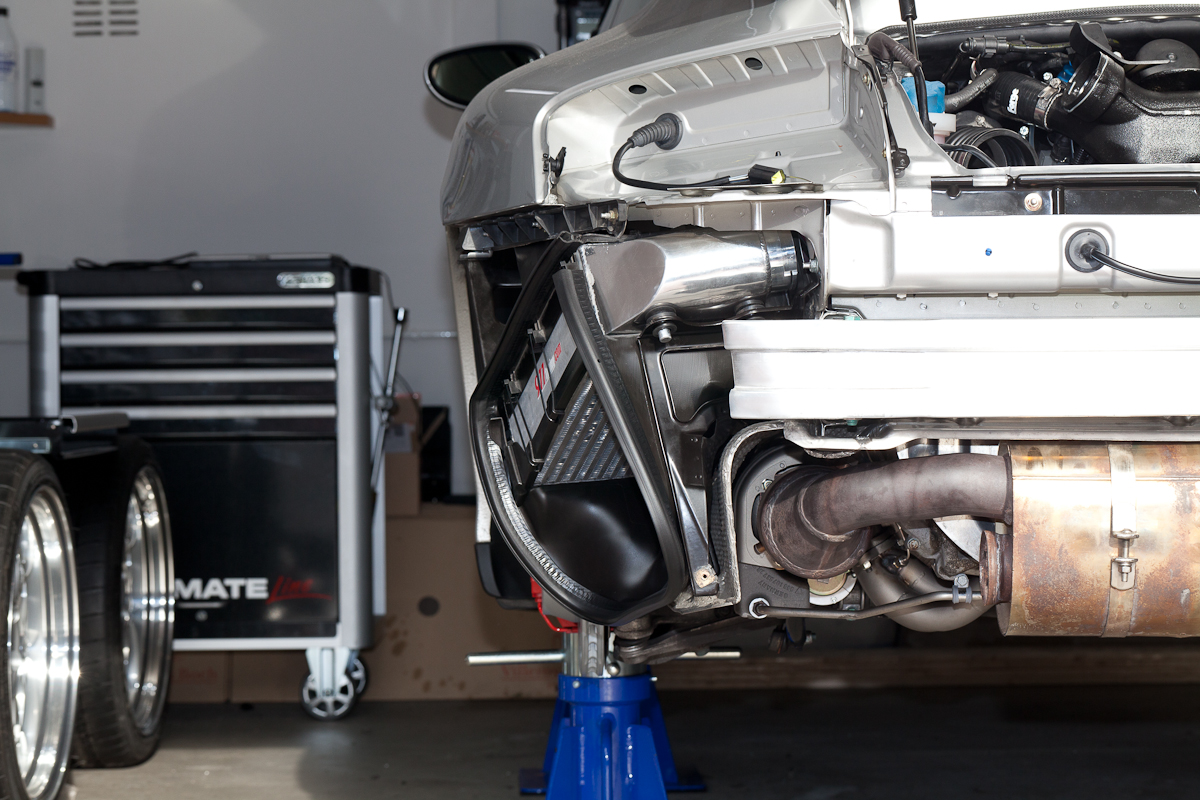

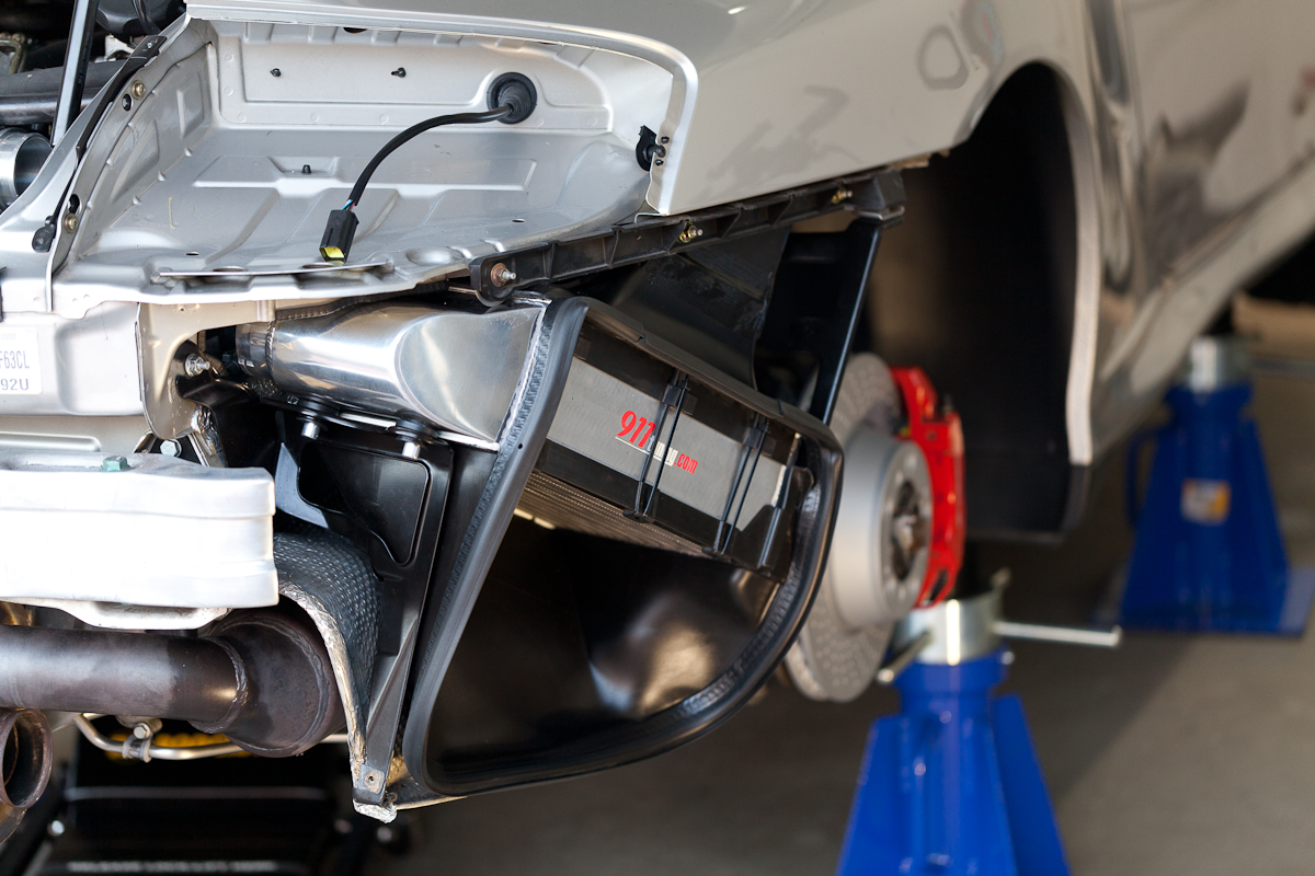

Originally Posted by BlackHorseTurbo
FYI, air to air intercoolers don't even work over 150mph. The air flow passes right over the side scoops. I'm about to switch to water coolers soon. Constant 40 degrees.
You should consider that the concept is not only pushing air thru the side scoops. In fact the "footprint" of the side scoops in direction of the air flow is rather small, but it will always work as "air-catcher". I think Manthey had side scoops that stood further out to catch more air - I have no idea if that ever has been a proven concept or just a gadget.
In addition the rear bumper works like a venturi tube. The air passes the car on the sides and on the bottom at high speed and at the same time air is soaked thru the side scoops as well because of the low pressure area that gets compensated. It works like a straw with a small end on the scoops and a big end on the bottom and the IC is in between.
I would hesitate to go with water coolers as they will heat soak pretty much and you add weight to the car as well. That amount of water is better carried as water/meth mixture and your IATs will allways be low.
I will be spraying water/meth and I will be doing it pre-turbo because that's the maximum delta T I can work with and at the same time the better pressure ratio will make the turbo work more efficiently.
The spray will flow with the air into the turbo. After the ICs there will be another set of nozzles. This is for direct vaporization in the combustion chamber.
I my case this is for safety reasons as I don't have a built motor (and for the fun of it, I must admit). I do have Marks 4.5" intercoolers and they are as well a wonderfull piece of art and a high tech intercooler that works extremely well according to my data logging.
Just my thoughts. It will be interesting to see if your water cooling works for you.
Andreas

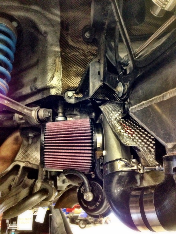

The water based coolers have already been proven in the 996TT. My IATs were 180*+ at the end of a Mile run where a similar car running the ice water were more than 100* cooler. That's good enough for me.

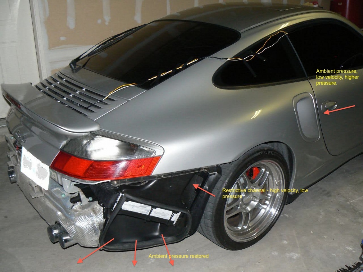

Todd, do you have an upper duct and lower duct with the 4.5 intercooler?

Only the lowers now that the rails are welded to the tops. But we sealed it off pretty well up top.
I don't claim to be an expert in fluid dynamics, but here's a thought. If the ducts have been removed, it may be causing some problems.
The upper and lower ducts serve as a conduit to promote the Venturi effect. The pressure outside the car directly in front of the side vent and the pressure of air behind the rear bumper serve to create a pressure differential in the long channel inside the fender (the narrow part of the upper ductwork.) This restrictive channel is should have lower pressure and higher velocity air used to cool the intercooler before the diameter expands once again through the lower duct and out the rear bumper.
This is from Christophorus (issue 300 specifically discussing wind tunnels and the 996.)
The degree of intercooler effectiveness influences fuel consumption.” That’s how the aerodynamics engineers describe the basic technical conditions of the turbocharged engine. Additional big openings, 130 sq. cm (20.15 sq. in.) in size, are necessary in front of the rear quarter panels. While this is ba- sically detrimental to the aerodynamics, it does improve air intake for the six-cylinder engine. The air is fed through a long channel, so that the 800-sq. cm (124 sq. in.) in- tercooler receives an even flow of air over its entire surface area. And it is compressed—because the pipe, at its narrowest point, measures only 98 sq. cm (15.4 sq. in.), and 280 liters (10 cu. ft.) of air have to flow through this bottleneck every sec- ond. Forced breathing, as it were.
For your setup, at higher speeds, I have a feeling even nitrous cooling sprays won't help as there isn't enough flow because the Venturi channel/shape is gone.
