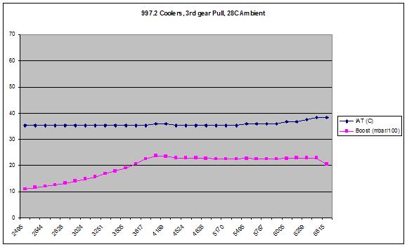

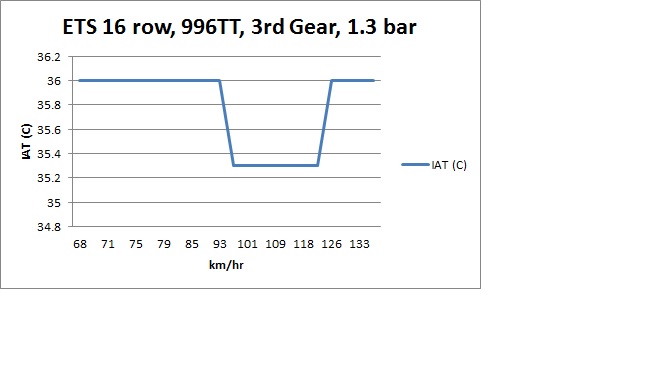

Maybe going downhill but did you look at his graph, its at 33 degrees the whole run WOT or not, it just looks like something is off, there should be 1 or 2 degree fluctuation up or down unless he was coasting.
But at 1.3bar WOT even in first and 2nd, there's going to be some increase in heat.
Even your graphs on ETS go upto almost 50 degrees, you mean from 3rd to 4th expect 20 degree change?
Not trying to be a d1ck just trying to make sense, it looks like something is off on the IATs.

I think these are great questions -yes, with 4th and into 5th a bit, expect a quick rise. That's why its important to get deep into 5th (and 6th) if you can to test a cooler (assuming you care about that region).
Here is a 3rd gear snippet from the logs with which the above data was produced (and also a similar snippet of the gt2rs coolers in a 3rd gear pull). As you can see, not much happens! You may even see a quick dip as the increasing airflow across the core due to increasing speed is temporarily outpacing the effects of charge air heat into the core.

Wolf, thanks so much for the data, but how is it possible the IAT's don't move by even 1 degree, its just a straight line.....
Not doubting you but could something be off on your setup?
I will thrash it next week for an hour or so and log some as a I go along.... and then do some pulls and log the last one.....
I did notice though one day I drove for 30 minutes, came home... then logged the car on idle (hot) and the IATs were in the low 40C range... then drove it and watched the live charting and IATs fell to as low as 32C ... driving was just quiet and normal up to 70 mph....
I will do a full run as I said and post...
It will be in the 85F to 90C range next week so we should get an idea. I feel it best to do these across a range of situations as one simple pull is not representative of how anyone drives. I think powderhound here has some road course data as well for his set up on a race track
