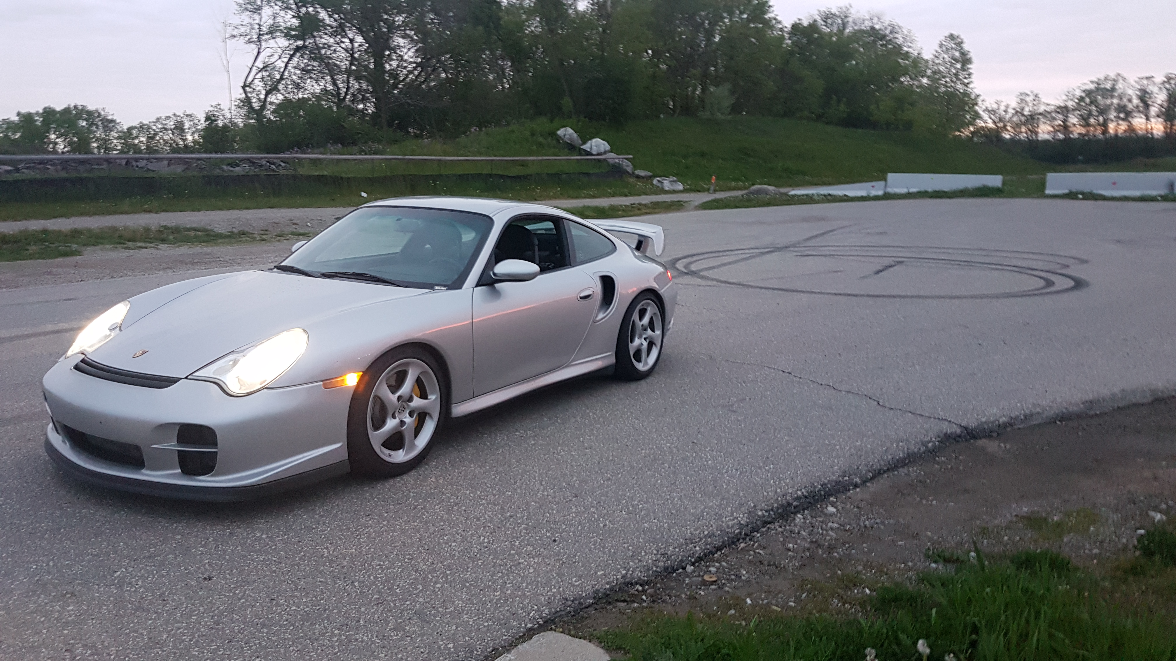

easier job for rwd/lsd

awd system in 996 are either very strong or near non existent, depends on the VC condition
