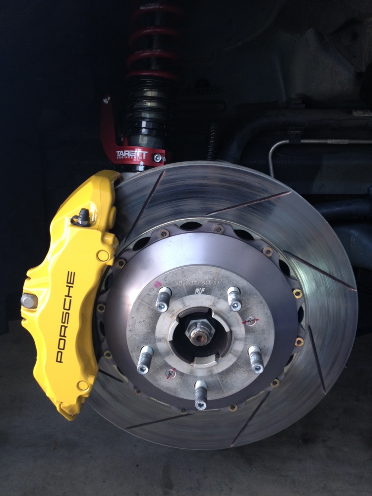

Tarett extended drop links are an excellent choice and provide the optimum drop link geometry.
Pretty cool looking caliper bracket, what type of calipers do you run?
Old Apr 17, 2013 | 02:34 PM
pwdrhound's Avatar
Joined: Jul 2010
Posts: 4,848
Rep Power: 457
I run front and rear 997.2GT3 PCCB calipers with 380/350 rotors. The brackets you are referring to are the OEM brackets (made by Brembo) that Porsche puts on the front upright of 997.2TTs with PCCB 380/350 brakes. These are obviously a direct bolt on to the 996TT cars also.
