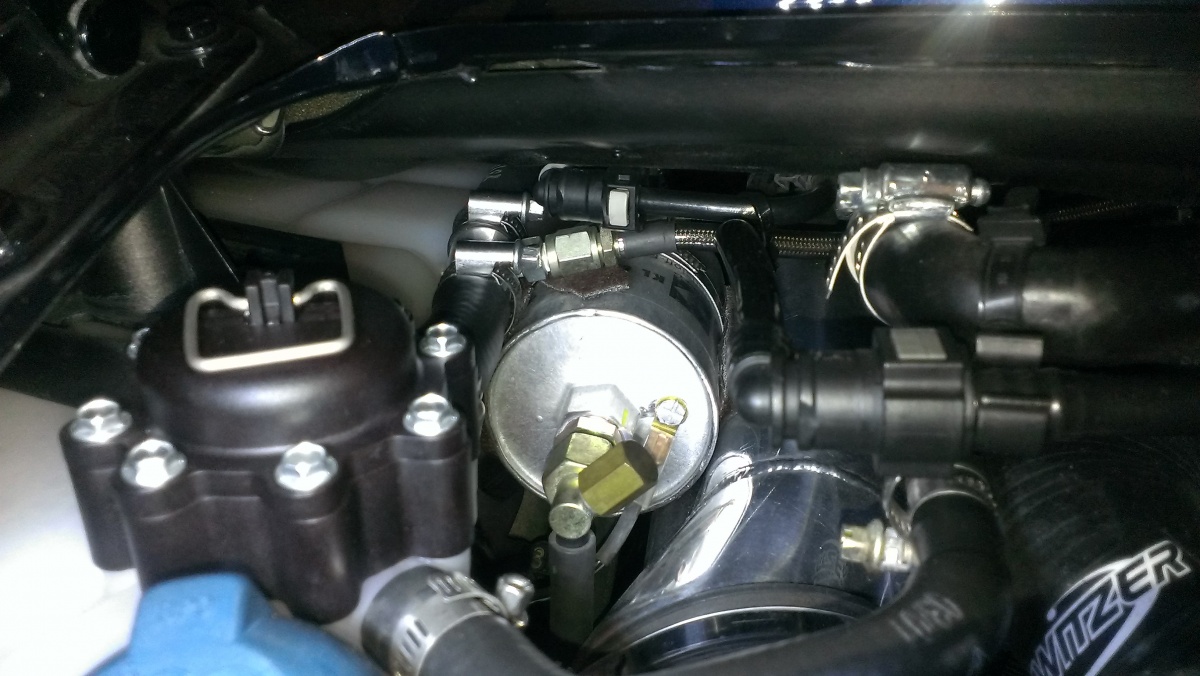

I used a different line. The one in front looks like it goes to the same place and it is much easier to access.

no good.. I dont like hooking in there at all. I dont even like the line that they want you to cut in to. when you shut off the engine after a hard run it will boil over the coolant. I tie it in to the line behind the power steering pump.

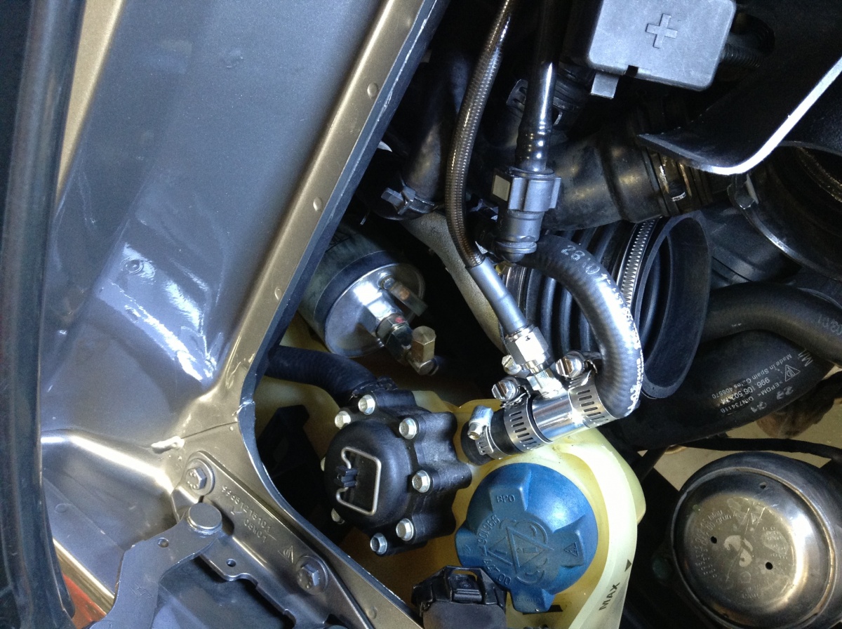

I don't remember that as being a problem when I installed mine. It tucked in there very nicely.

if you remove the fuel filter and the intake plenum then theres more than enough room to work in there.
