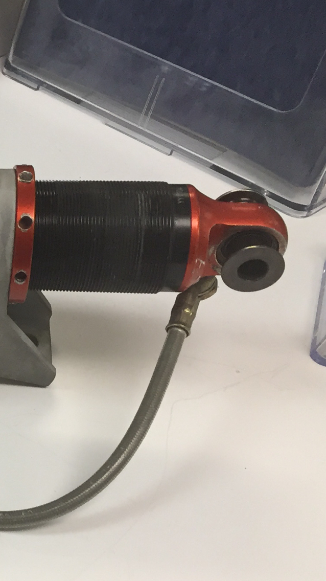

Originally Posted by pwdrhound
If you have the Cup shocks you should have a bushing (996.333.565.9A) on either side of the spherical bearing. These will allow a certain amount of shock rotation by their design which in my opinion is less than ideal. On the 996Cup this is probably not much of a problem as the car is light with heavy springs which limits how much suspension movement you have. On my rear shocks, JRZ uses a much better design where the bushings on either side of the spherical bearing is much larger and is sandwiched between the shock pin mount and the wheel carrier thus preventing the shock from rotating. There is still a tiny amount of movement +/- about 1mm or so to allow the spherical bearing to work but that's it.
In my opinion, the only way to battle the movement you are seeing is to make sure when your suspension is loaded that the drop links are attached to the brackets at as close to a 90º angle as possible. This will minimize any kind of torquing of the shock by the drop link as the suspension deflects. The other option would be to have some custom bushings machined similar to that of the JRZ design. If you can measure the ID and width of the spherical bearing, I can check to if it matches the JRZ bearing. In the off chance they are the same you could use the JRZ parts which I have in stock.
These are the bushings mine have. Not sure of the part numbers.

Yep. Those are the OEM bushings I referenced. You can see the difference between the design of those and the JRZ ones which eliminates any chance of shock rotation.

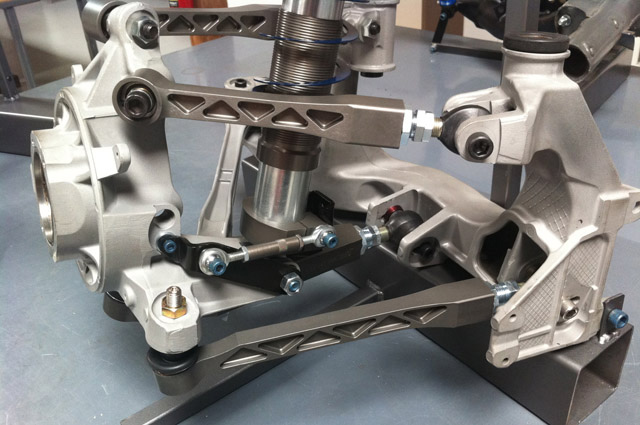

Exactly, sway bar links attach to the upright instead of the coilover body.
Originally Posted by r0nd3L
I had to look up some photos. Interesting. Does the sway bar connect directly to the upright
