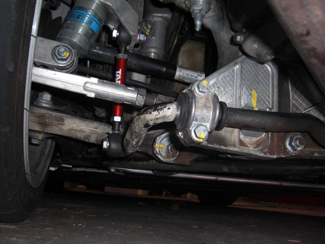

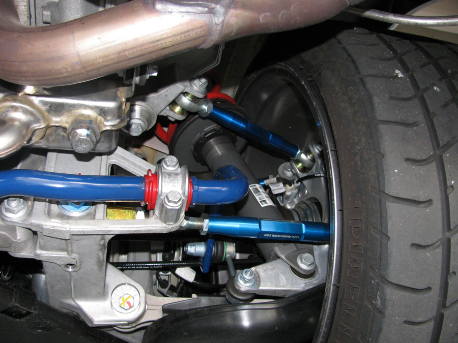

Another thing to be cautious of is the 997 GT3 street spindle setup will need a new rear sway, links and the rear shocks have a clevis type mound versus a spherical bearing and offset spacers. So you will be limited to just 997 suspension options. The 997 cup rear spindles use the same shock end mounting as the 996 in the rear and does not require a different sway setup. Basically the 997 spindles are an upgraded 996 RSR spindle from the aspect of geometry. They may have changed the casting part numbers but they are essentially the same. The brake caliper bolt spacing changes based on which car they were intended for. Not sure what all is involved with the PASM suspension conversion, but sounds pretty involved. If you get it setup right it could be a nice setup though.

As for the ABS sensor, i spoke to a guy who works nothing but motorsport and street ABS systems. He works a ton of cup and other racing applications. The new longer style ABS sensor will not work with our ABS. Ours uses a passive magnetic pickup. The new street sensors get an excitation voltage from the ABS. I even asked about an interface box and nothing was available. Your only choice is either ABS retrofit or machine spindles for you sensors.
I advise going with the 997 street rear spindle and cup front. That way you only have to machine rears for our sensors. The rears should machine okay for ABS sensors as the 997 cup uses the same casting with old style sensors.
Yes. I've looked at the sway bar configurations. From pics alone, it looks like it's possible to do with the sway bar hanging no lower than in your second pic. The link would end up being quite short, though and it might not leave enough lateral movement for the sway bar end/upright. We'll see. No one is doing it so there is likely a reason. No biggie either way.
