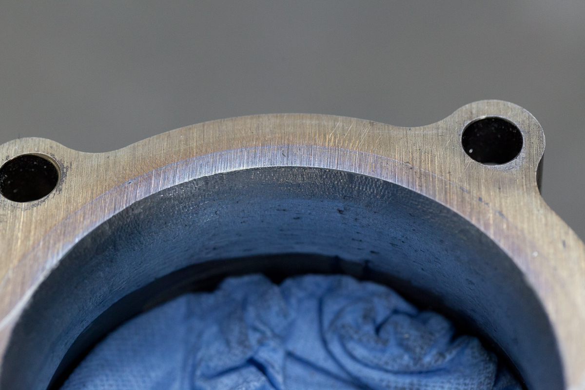

Just a quick update on the exhaust work:
I had some problems with my turbos and I wasn't happy with the lag of my K24s, so I decided to upgrade to Tial Alpha A28s. I like the almost instant on boost more than top speed, which I don't go for too much.
The exhaust has custom 5" cats with big cones and hence a little work on the flanges was necessary to not block the internal wastegate pipe of the A28s. I grinded the flange and have opened it up a bit.
While I had the tool in my hands, I also did some porting on the A28 turbine inlets as well. There was quite a step inside the flange (see original pic).
Thank you Mark for the exhaust - I still like it very much.
And thank you Sam for the A28 deal and your support. It was a pleasure working with you.
Andreas

I assume these were not 18g's ?
factory K24's ? Just curious. I prefer the torque down low, and sometimes wish I would have gone with A28's or K16 Billets instead of K24/18g's. The 18g's aren't that laggy, but I think I would prefer full spool 500+ rpms to the left.

These were kinda 18Gs. K24 with 2480 wheel. Flows is like 18G, but the wheel is lighter. Still not what I prefer.
