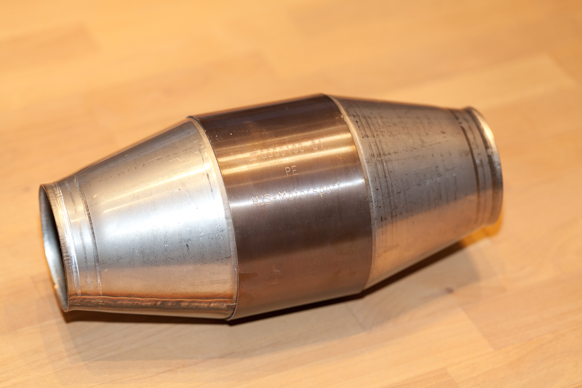

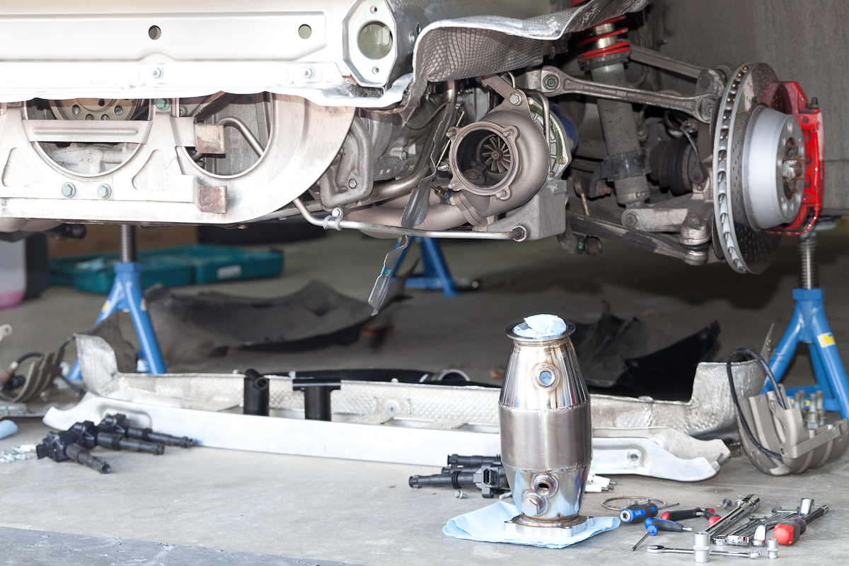

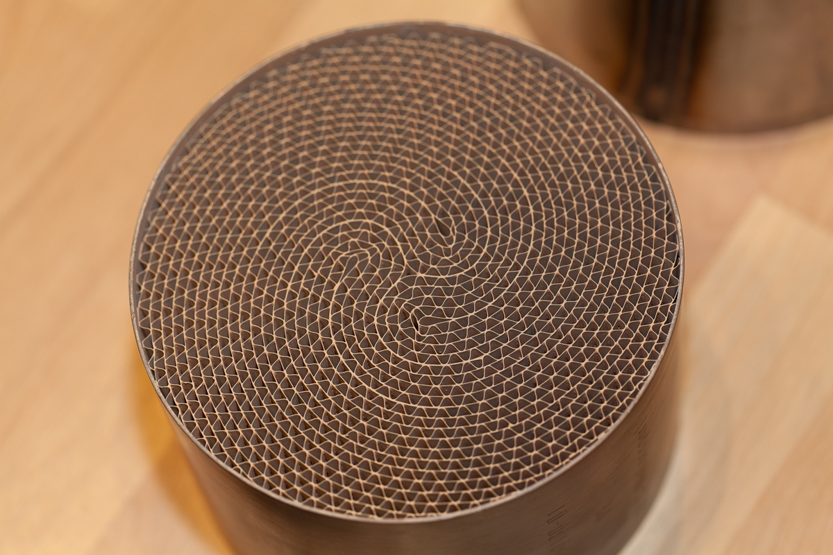

HJS 100 cell 5" PE Foil catalytic converters:
ID:	238207   Click image for larger version
ID:	238208   Click image for larger version

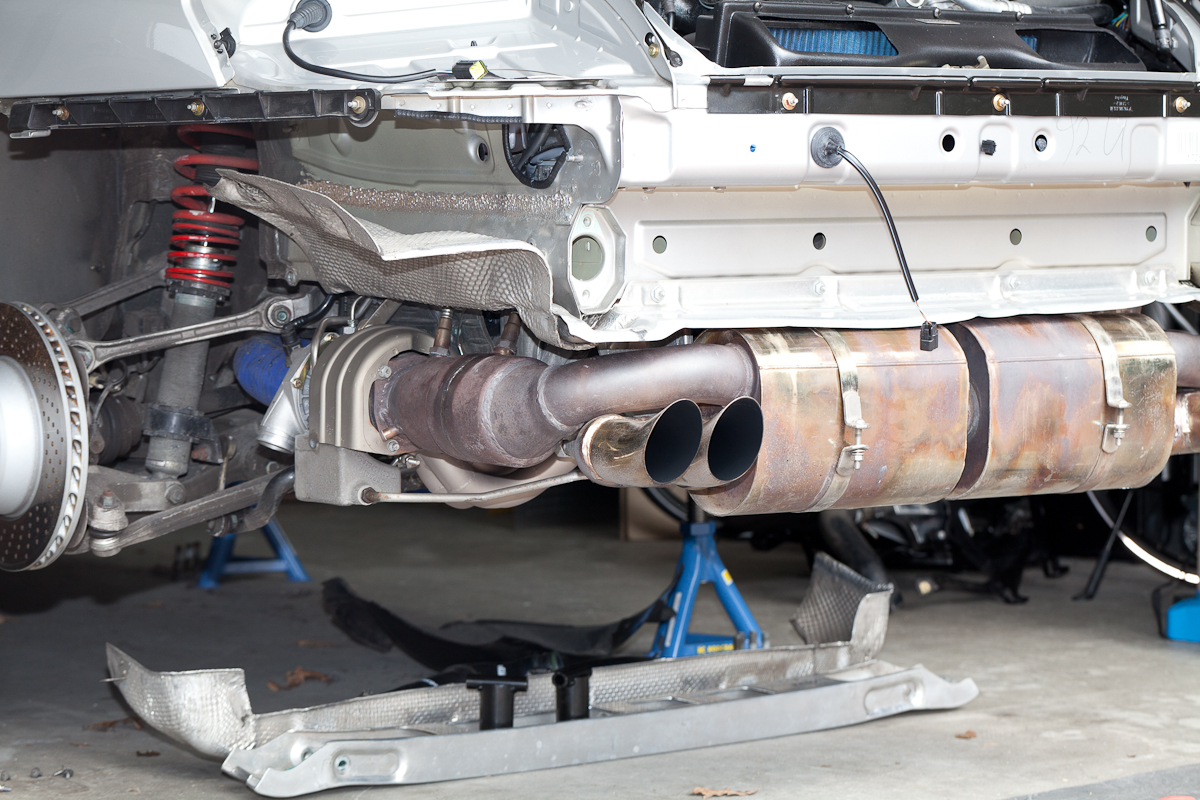

My old Gemballa exhaust:

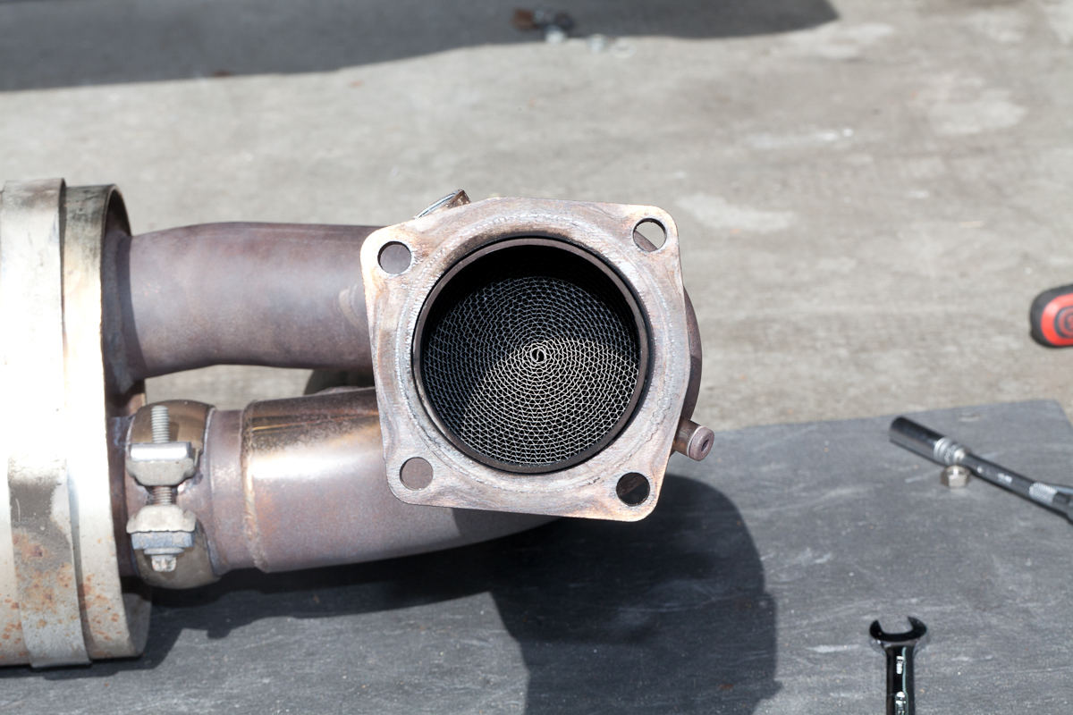

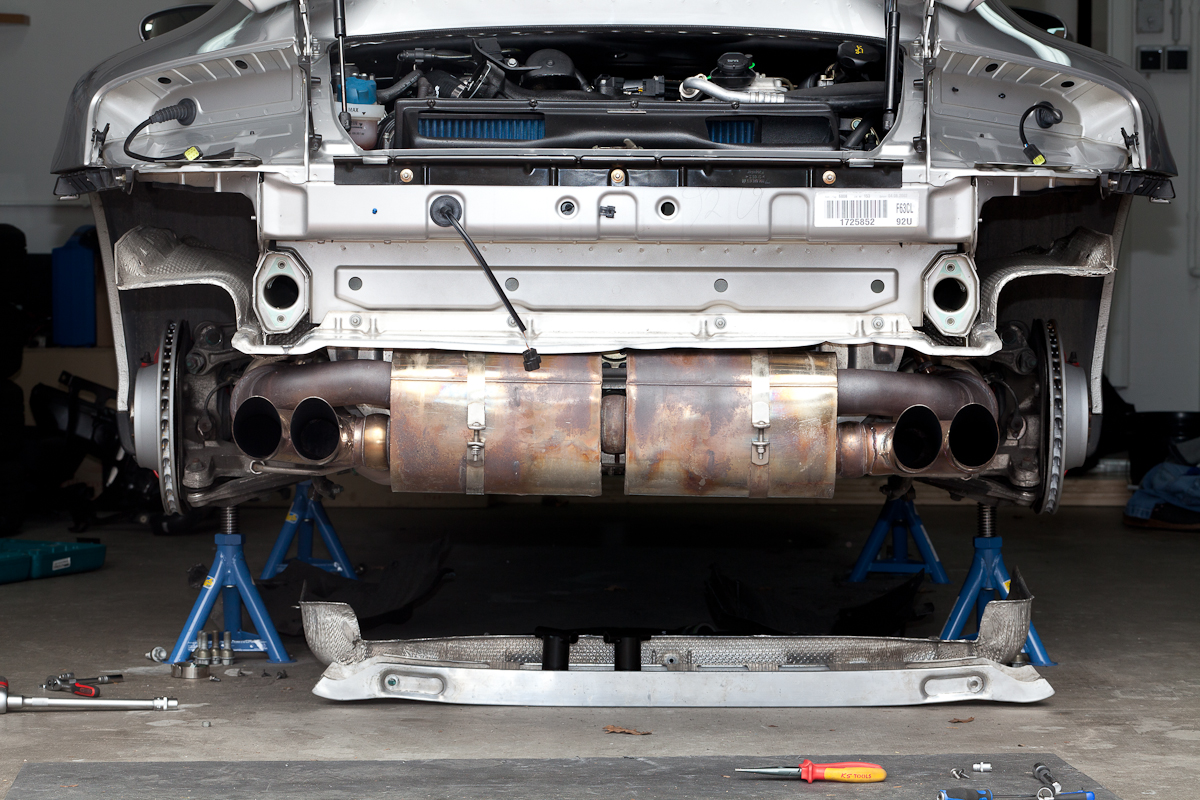

GT996 has a reputation beyond reputeGT996 has a reputation beyond reputeGT996 has a reputation beyond reputeGT996 has a reputation beyond reputeGT996 has a reputation beyond reputeGT996 has a reputation beyond reputeGT996 has a reputation beyond reputeGT996 has a reputation beyond reputeGT996 has a reputation beyond reputeGT996 has a reputation beyond reputeGT996 has a reputation beyond repute

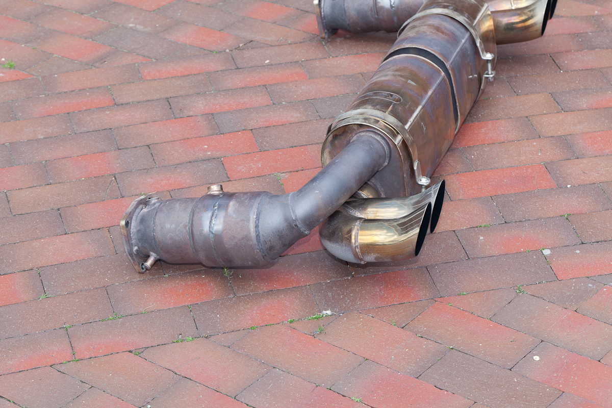

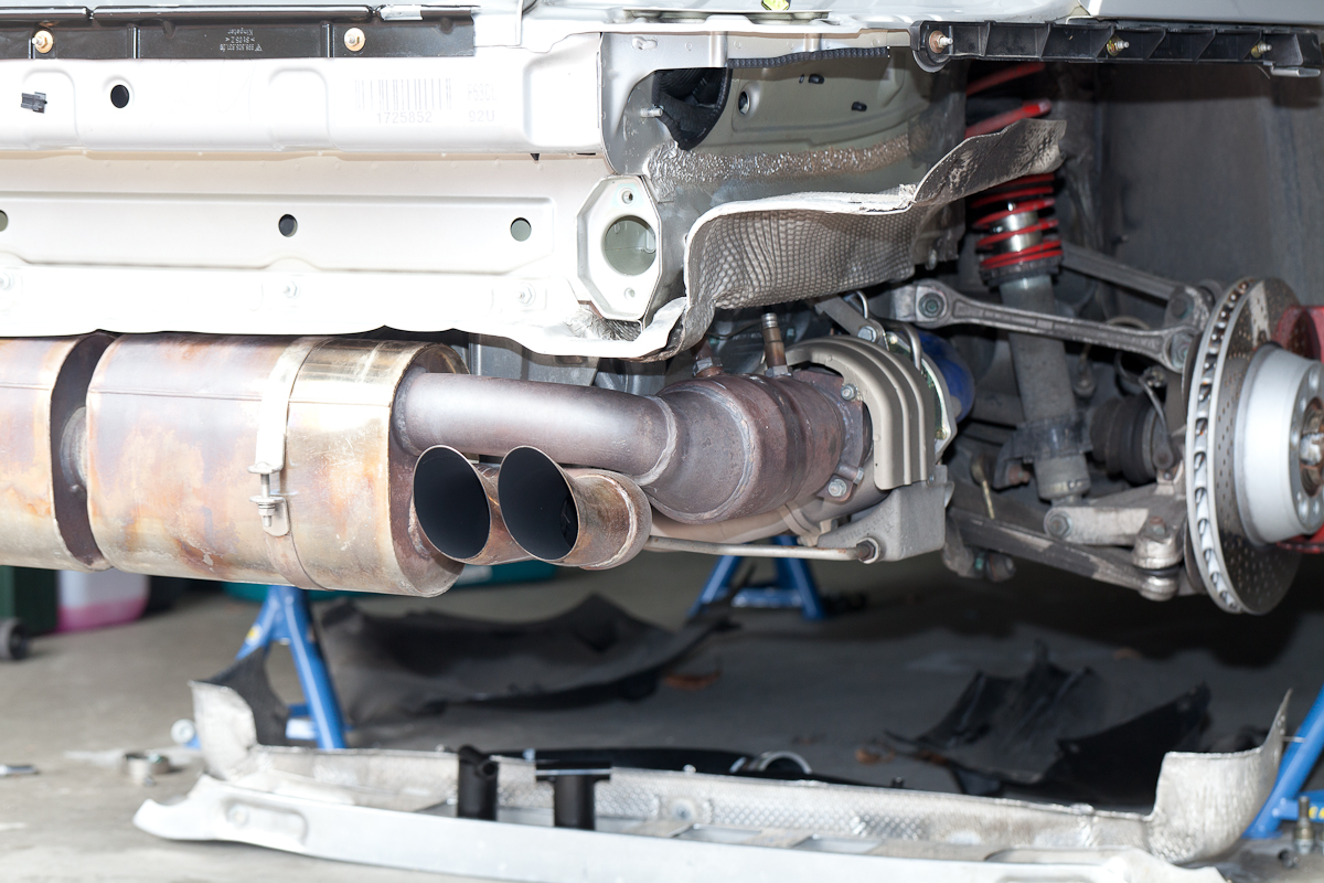

Gemballa exhaust detail pictures. The cat sections are 200 cell plus 300 cell = 500 cell. Kinda choking....
The 2nd cat has been cut out already.

What are the HP ratings on those cats,, as HJS gives that info?
I will be selling my 100cell 5'' HJS cats,, 350hp each rated, soon.

The HP ratings on the cats are coming from the DMSB and FIA homologation and the corresponding classes. 350 HP is the rating for each cat cell and this is only a value for which a linear backpressure response is given.
Of course you can push more gas thru the cat, but beyond 350 HP the backpressure may not raise linear with more exhaust gas and also the catalytic efficienty will be degraded.
I was talking to the product manager at HJS Germany and he gave green light for 750-800 HP with these cat cells. This exactly matches my needs.
They are expensive. I learned here that this is the only valid sign for good catalytic converters, so I am happy that I have the best catalytic converter money can buy.

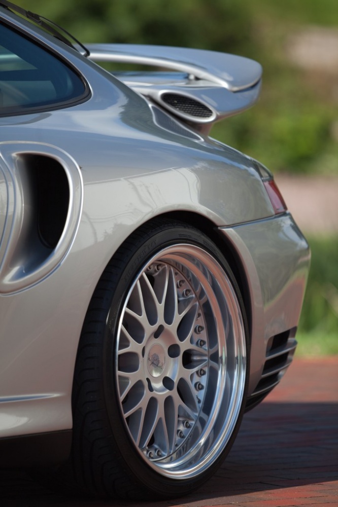

Thank you. Unfortunately I recently was lying more in front or behind of my car than driving it. It looks like this when clean and on it's tires:

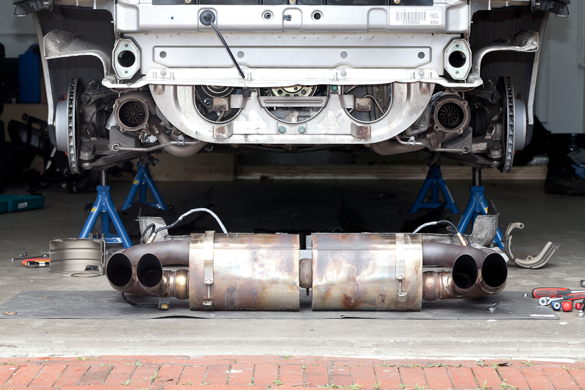

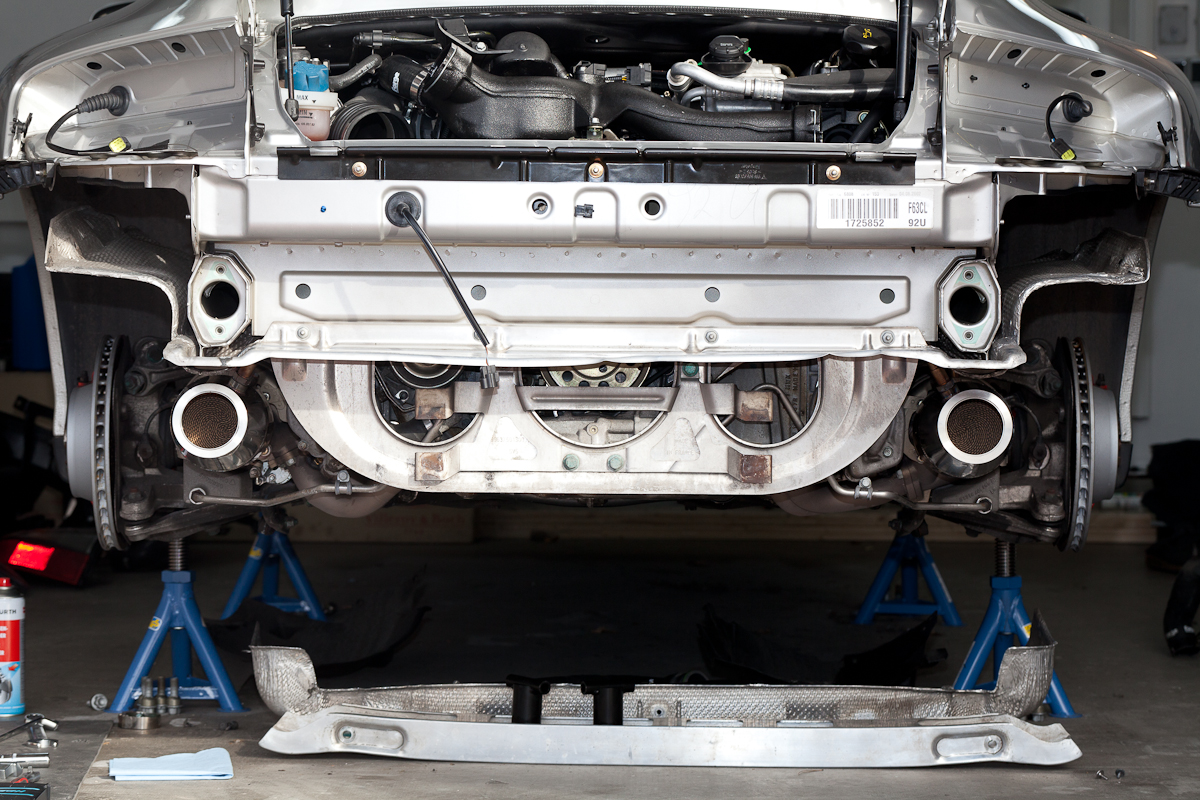

Originally Posted by MARKSKI@911tuning
Glad you got the exhaust on now show some pics lol

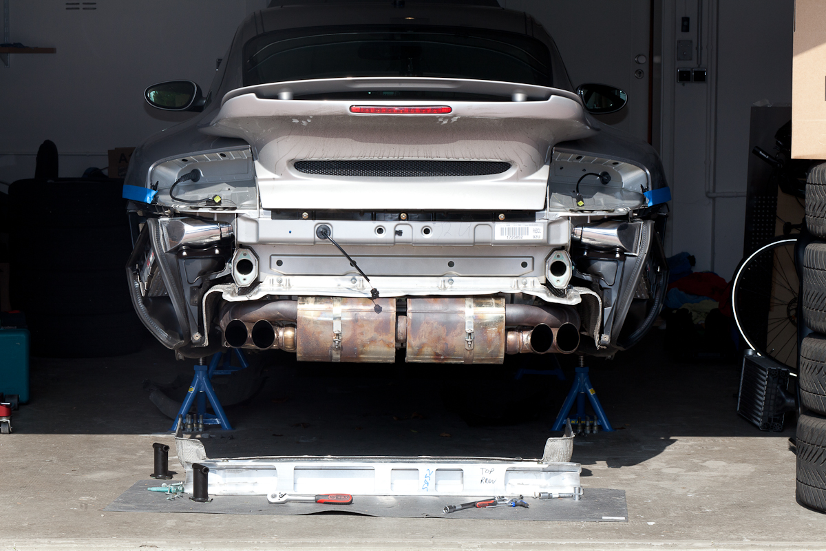

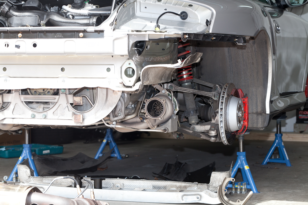

Here you go:

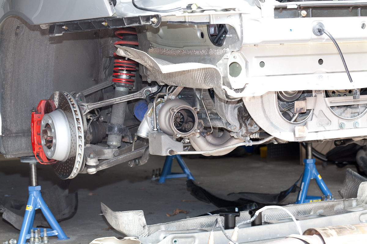

Deinstallation of the old exhaust
ID:	238757   Click image for larger version
ID:	238758   Click image for larger version

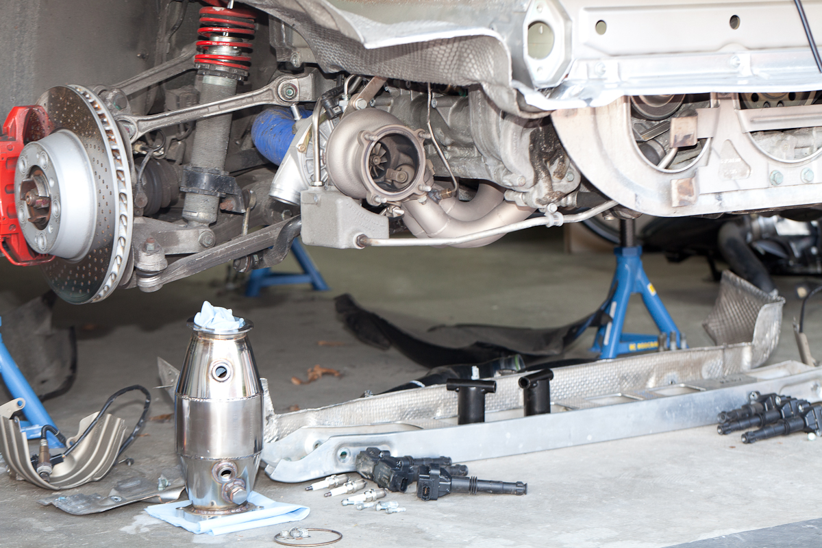

Old May 3, 2013 | 12:11 AM
GT996's Avatar
Joined: Oct 2011
Posts: 429
From: Germany
Rep Power: 61

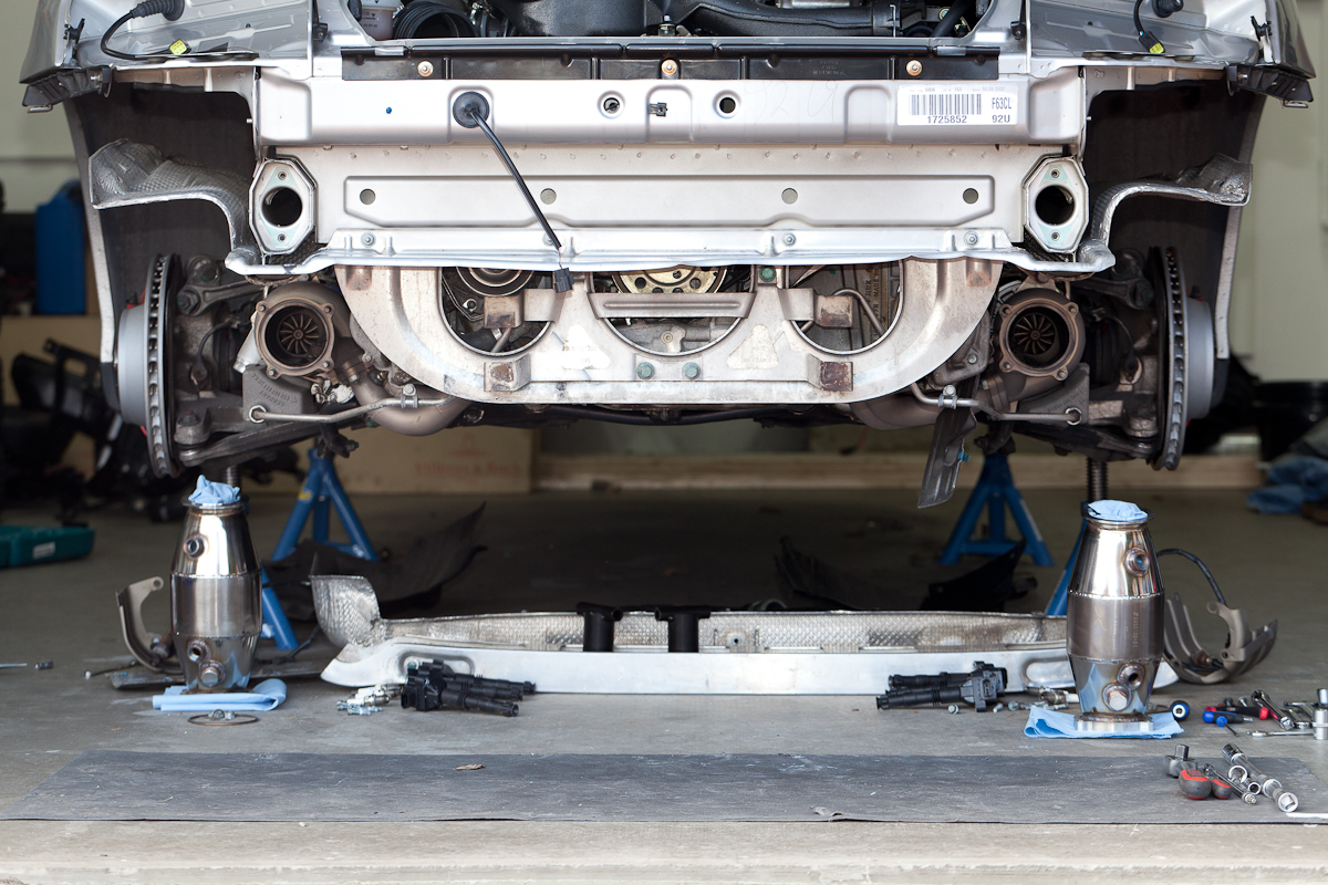

Preparation for the cat install. While I was at it I also did new plugs first and gapped them slightly different.
ID:	238760   Click image for larger version
ID:	238761   Click image for larger version

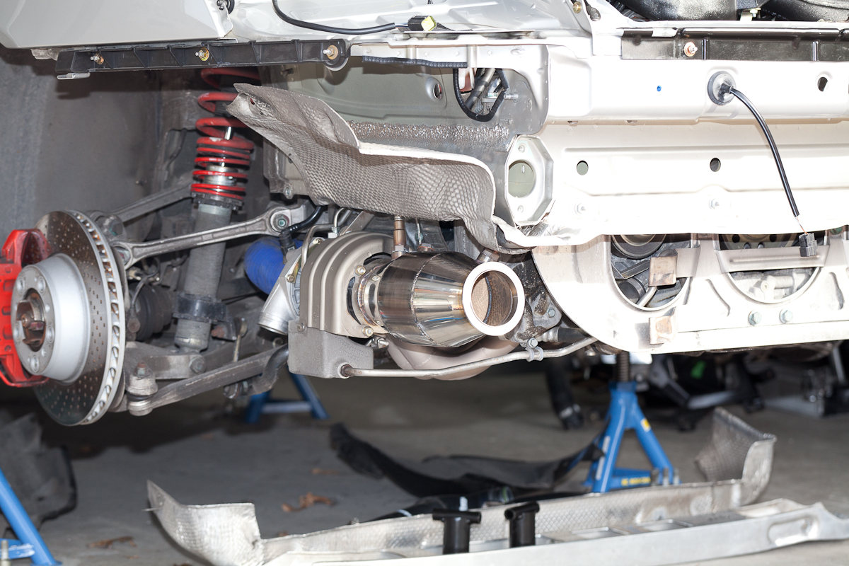

Old May 3, 2013 | 12:17 AM
GT996's Avatar
Joined: Oct 2011
Posts: 429
From: Germany
Rep Power: 61

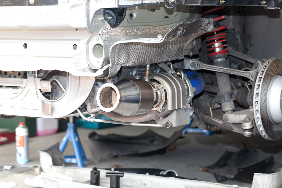

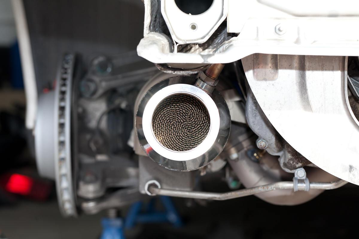

Installation of my shiny new catalytic converters. The cones have been welded to the cores and the cats have been polished. I also got a 2nd O2 probe plug before my cat for 2 purposes:
- ECU independent O2 measurements with seperate O2 sensor (to be installed later)
- backpressure measurements
ID:	238763   Click image for larger version
ID:	238764   Click image for larger version
ID:	238765   Click image for larger version
