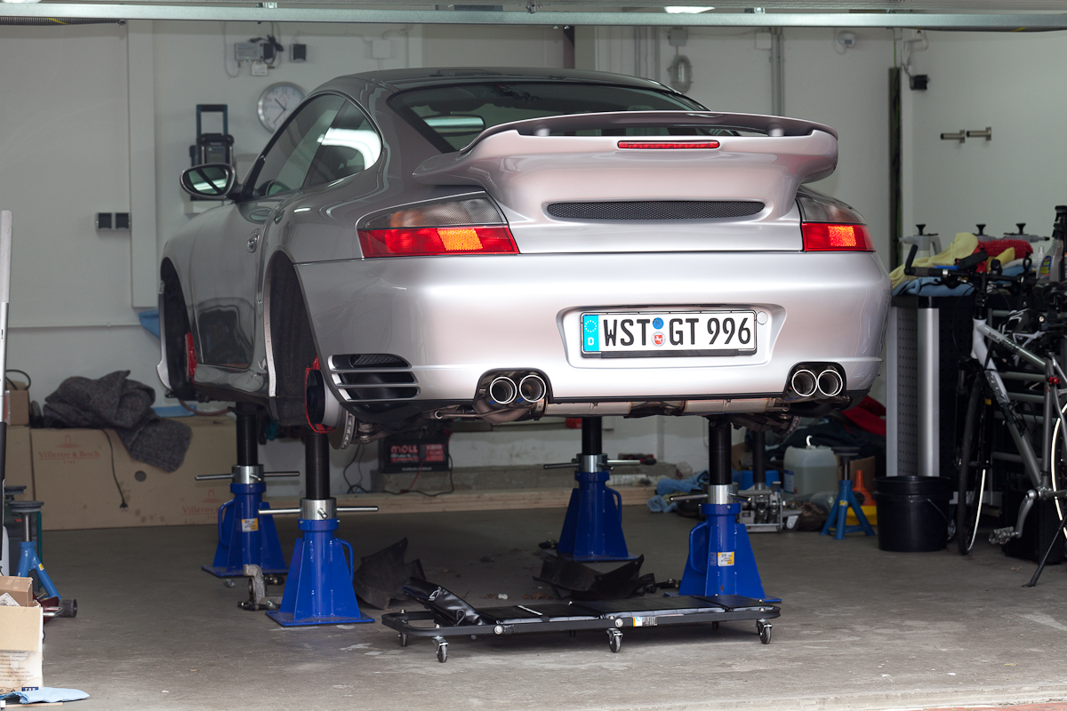

Here is a pic of my cool manual lift and to be on topic: the final work on adjusting the tips has been done.
Andreas

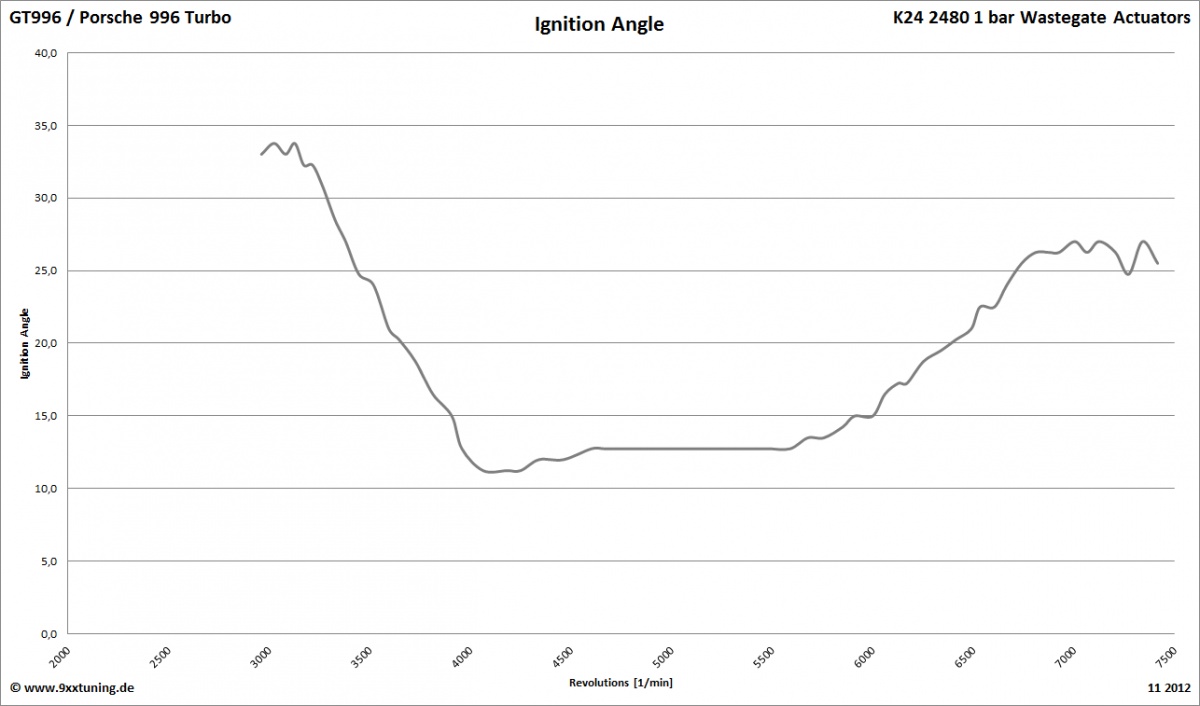

I have not figured out to get Durametric read knock sensors. Did I miss something?
What I have is this data which I had put into pictures for easier readability. Revs are running linear, no hint of spinning wheels or PSM in action. Load is looking ok (Load Index is being made up by me. It is just the area under the curve in order to see improvements or losses between changes). Load is calculated (VE based) and not the ECU value.
Ignition breaks up between 4-4.500 rpm. Coils are fresh and plugs were almost new.
Andreas

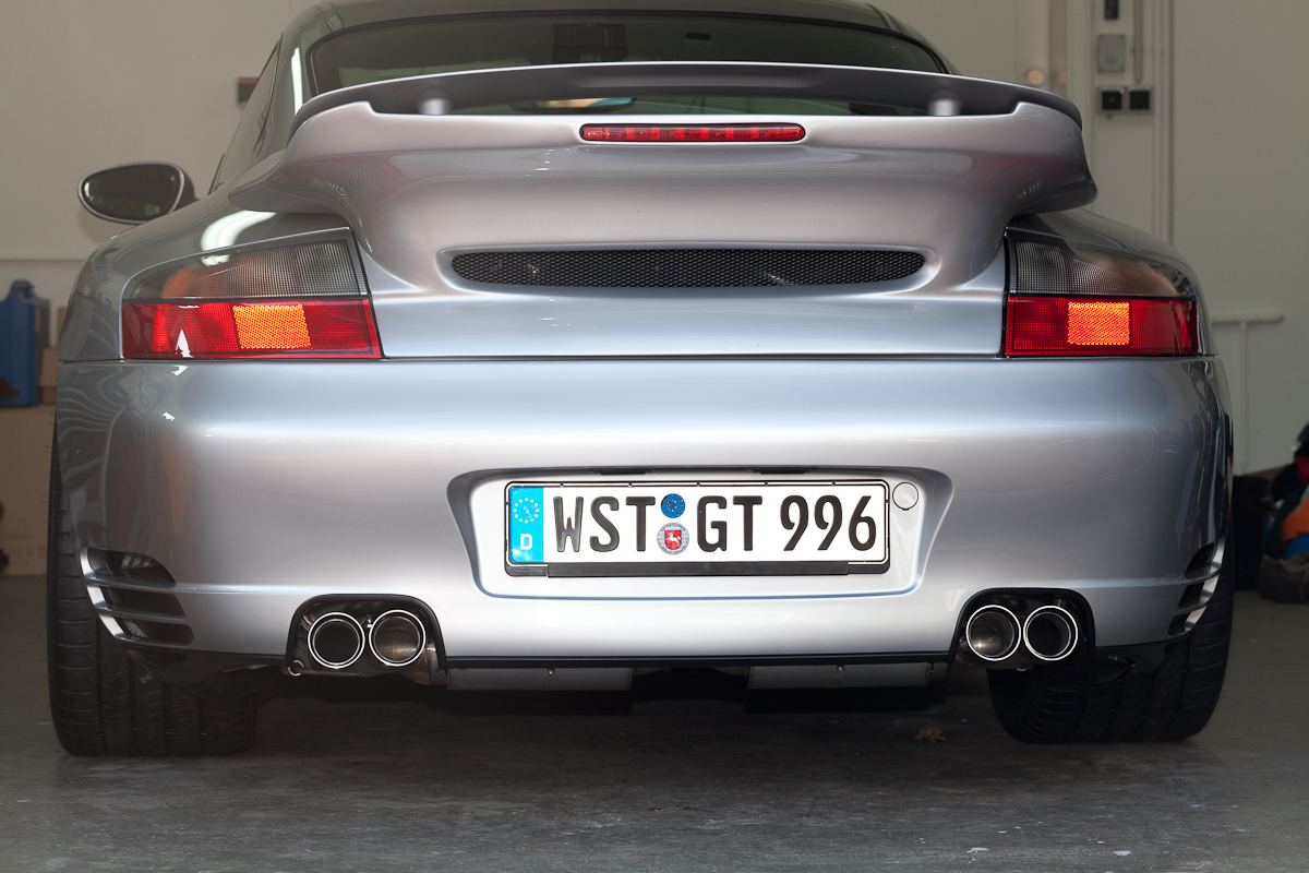

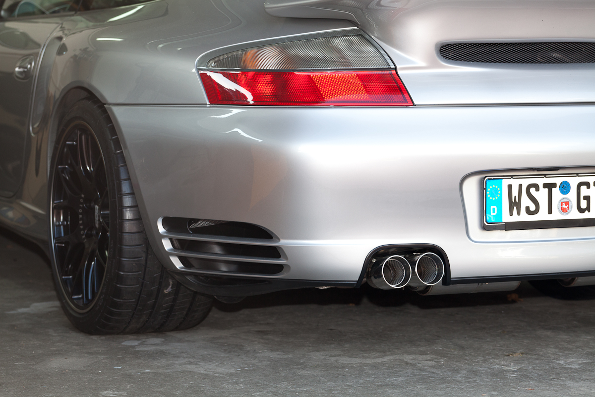

my car is back on its feet again. The detailer who worked on the step lip Gemballa wheels did a bad job and these wheels are "on hold" right now until the issues have been resolved.
Since I need wheels for the winter time anyways I decided to get some BBS CH-R and put Michelin PSS on them. The coating makes the wheels look almost glossy and not matt, as they come. I like that.
Next step is putting the new 997 seats in and then finally I will be able to drive that car again
Andreas
