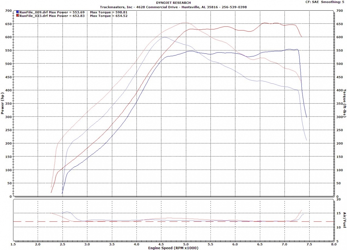

It seems that there's always been a comparison between the 16 billet
setup and the a28 setup. There's the implication that the a28 is a
similar turbo and that moving up from a k16g or 16 billet isn't a
significant difference to justify the money.
I'm posting an overlay of my k16 billet setup and my a28 car. Both
setups were and are extensively mod supported. In fact, both setups
broke their respective 60-130 records on 6speed. Both setups were
performed on the same dyno and the conditions were very similar.
I thought this might help some guys who are on the fence and maybe
put to rest some of the speculation and armchair mechanic philosophies.
The a28s really do out spool the k16s and power under the curve is
a little more then marginal.
In other words, it's about as apples to apples that you can get without
qualifying for a debilitating case of ocd.

if im correct thats at 1.4 bar on ms 109 for both. very nice comparison. i think the biggest issue when considering 28's is everyone wants to go 3071 or bigger because the cost is so close.
Good point! Actually, 3076s can be cheaper because low end torque
isn't an issue so you don't have to build the motor! If you wanna run
more then 1.4 bar on 28s you better build the motor
If a fellow is looking for a street / track setup that'll run with the big
dogs, the alpha 28 car is just what the Dr. ordered. The 16 billet is a
good setup but it's not in the same league. You have to compare the
28s to the 3071s and 3076s IMHO. Look at the area under the curve Steve

Originally Posted by sinKing
Just for clarification I thought you had 16g's as in upgraded k16's but not the billets.
You are correct sir! Interestingly enough, no billet car has even come close
to my 5.87 60-130 record.
Those 1500.00 Vivid racing turbos produces consistent 6.0s 60-130
and I even recorded a 10.7 1/4 @ 132 or 133 on the vbox. I'm sure
a better 1/4 mile driver on a prepped track could have easily got 10.5s
at 135ish.

Either way I'm pretty impressed with how quickly the turbo that is making more power spools up compared to the 16g. I wonder where the 3071 spools up compared to the 28.

You do have very good results indeed and Markski did a great job for you..Congrats again.
But I to say, I have seen a few Dyno comparisons from switching from A28s to 3071s with the pretty much the same mods /fuel and the 3071s made so so much more on the upper mid to high band that the little that was lost on the low mid to the A28s was nothing compared to the gains after that..
So I believe the 3071s would be easier to live with, less hard of a hit down low, and easier on the rods if the boost wasnt over done..
Just my info and my thoughts...
That's a good question, but I bet they don't keep up with the a28s!
The 3071s look like a great setup though. They'll put down 680+ whp
and word has it, they're not as laggy as the 3076s. The 3076s never
appealed to me because I think it relegates the car to straight line
performance. "Interstate pulls"
I think you make a good argument for the 3071s and I've seen some of those
comparisons with my own two eyes! The difference down low is a major
consideration if you are going to track the car and if you're gonna enjoy
twisties on the road. The 28 car will annihilate the 3071s, and 3076s for that
matter, on the track or twisties.
For most peeps I think the 3071s make more sense, on that we agree
The 16g graph is @ 1.45 bar and the a28 is 1.65 bar. The 16g setup died
at 1.5o bar so the 1.45 was near the peak of their performance.
Remember we ran the a28s past 1.75 and they stopped making power.
With straight pipes and c16 the alphas should push 1.85 bar and make roughly
680 whp. Prolly good for 4.9s 60-130
