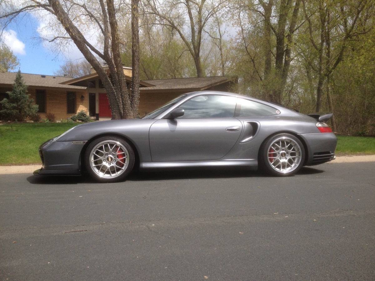

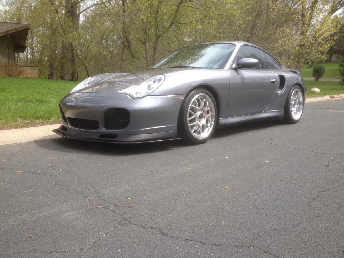

Heres a side shot for height...

Old May 14, 2013 | 07:48 PM
nyc996x50's Avatar
Joined: Jun 2012
Posts: 200
nyc996x50 is infamous around these parts
just curious if the rear tires rubs.
No. Not at all.
For street, I run factory size (18") and factory offset wheels and standard size tires (as seen in photo), and these are with 18mm spacers in rear, 7 in front.
For track, I use the factory hollow spokes with 315s and 245s, with no spacers, and they don't rub either.
