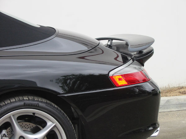

As I mentioned i have 2 small gremlins. Spoiler failure and oil pressure indicator.
Ive read a lot on the spoiler failures and going to tackle this one first. I can raise and lower the spoiler via the button on the dash and the wing moves about an inch or so. It still gives me a warning light though Im not sure if it moves while Im driving. A go pro would be nice to film it...anyway how much travel is in the hydraulic rams? I found this picture.. is this the max extended height??
if i could offer some advice? do NOT touch the dash button or mess with them again, until and if you plan to try the re-bleed. there is probably just enough fluid in the rams to allow what activity you're seeing. if it deploys at 73-75? then just look into the rearview. if it's working you'll see it. if and when you DO fix it?
then you'll forever develop the habit of involuntarily looking in the mirror coming down offramps to ensure it's working it's as if once they've falied, and been repaired?.. the memory of "flaccid wing syndrome" still haunts many of us, to this day. it's an easy fix for those very mechanically inclined and the diy is all over in here. GL w it.

If i am suppose to see the spoiler in the rear view it definitely isn't moving up far enough, hence the failure light. but the good news I guess is the motor is fine and it moves evenly so looks like it needs just a top up on hydraulic fluid.

Back from travel and cleaning up after the floods in Calgary so ready to take apart my hydraulics for the rear spoiler.....I seem to remember reading a DIY on topping up the hydraulic rams in situ and of course I cant find the link again. I realize Id be fighting gravity trying to fill the rams, short of taking the deck lid off an flipping it over.
My issue is I cant get the wing up far enough to take it off then drop the rams out.
Any suggestions, is it possible to raise the wing manually? or even better fill the rams in place, i have the hydraulic pump out of the car...
