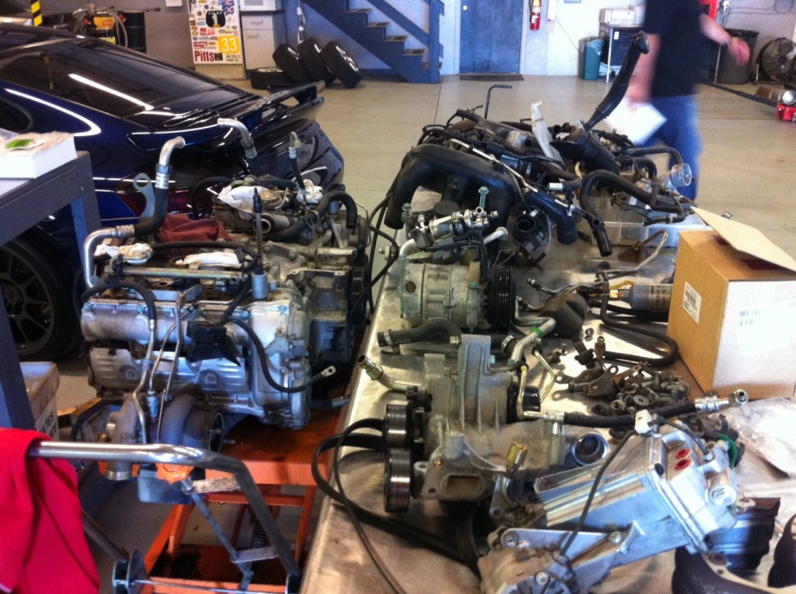

My fitting just let go today on my silver turbo on the last run of the day at auto cross at the tire rack .. 12 of us cleaning the track for an hour. Just fixed it with jb weld.. Grind with a dremmel , chemical clean , apply to both sides , let sit for at least 48 hours. At least I got ftd. My black turbo let go at ginger man raceway last summer. It was the one under the alternator for both.

I just looked at my invoice and the total was $1589 for the R&I of the motor and then $1000 for the welding of all 8 coolant fittings. The $1000 included the removal of all the fittings, cleaning and preparation, and the actual welding done by an FAA certified aircraft welder. There is a good bit of engine disassembly to remove all the fitting as you can see in the attached pictures. So you're looking at $2600 give or take.... If someone is quoting you $5K then they are bending you over.....
