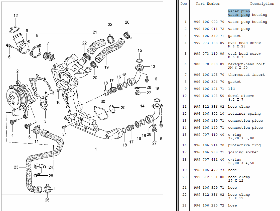

Does anyone have a schematic of the pump assembly? Or have a link to it. Of the 7 bolts securing the water pump to the engine 2 are different and I messed up the order so want to double check where the 2 odd ones go.

This shows where one of the bigger bolts goes... (#5. I don't know why the others aren't listed?!?!)

New pump in and the car is back together. Thanks SLIDER great write up, easy DIY...
