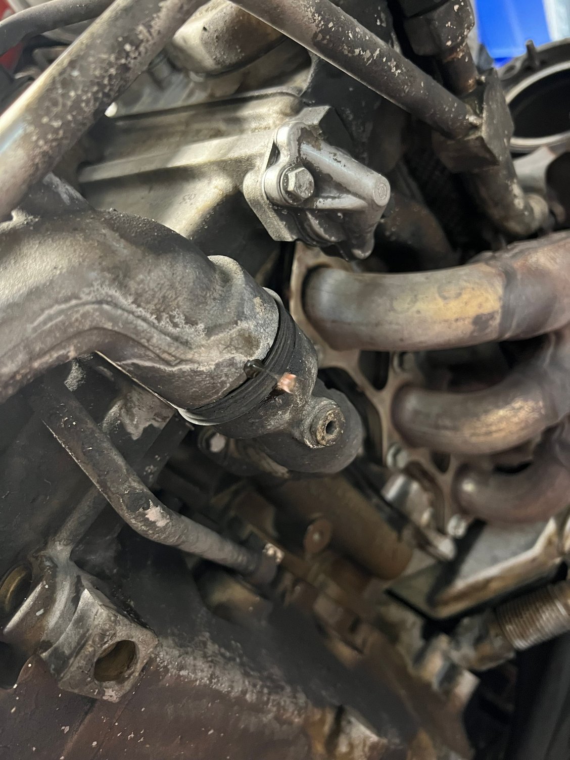

Ok, I'm doing this now, just lowered my engine and suddenly coolant started leaking from the seals next to the coolant drain plugs.
I'm assuming that isn't normal but coming from both sides.
Any help appreciated.
Also, the water pump is definitely bad, and there is definitely a leak from here, not trickling down from anywhere else.

It looks like you will have to replace some pieces...

Thanks! That’s exactly the info I needed.
Doing this water pump isn’t half as bad as the thermostat….man, those bolts are tough to get to!
