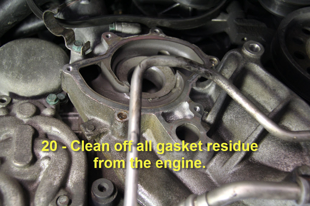

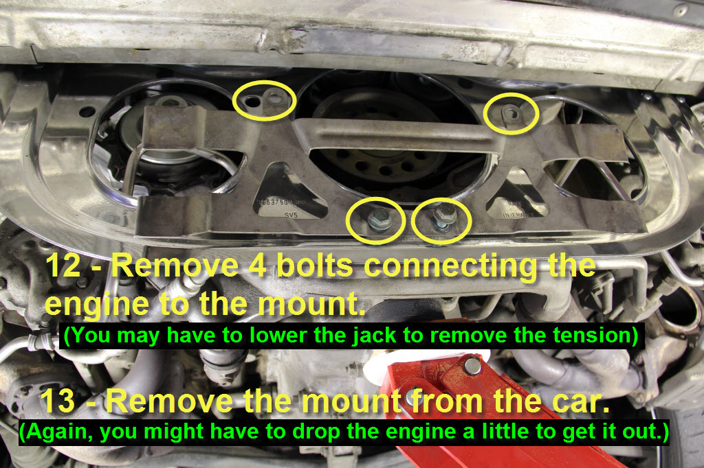

996 TT Water Pump Replacement DIY
I thought I would share the info from my last repair.

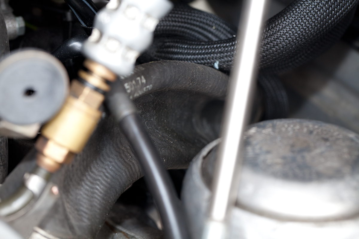

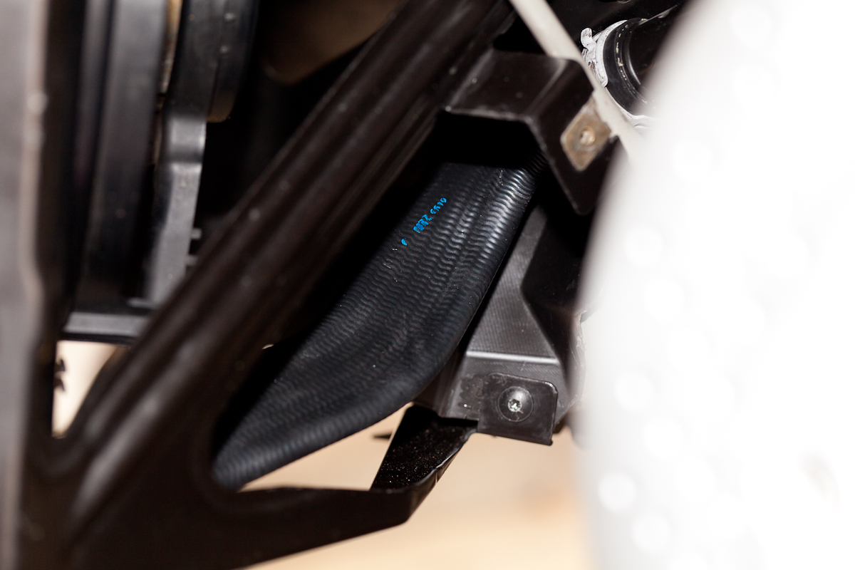

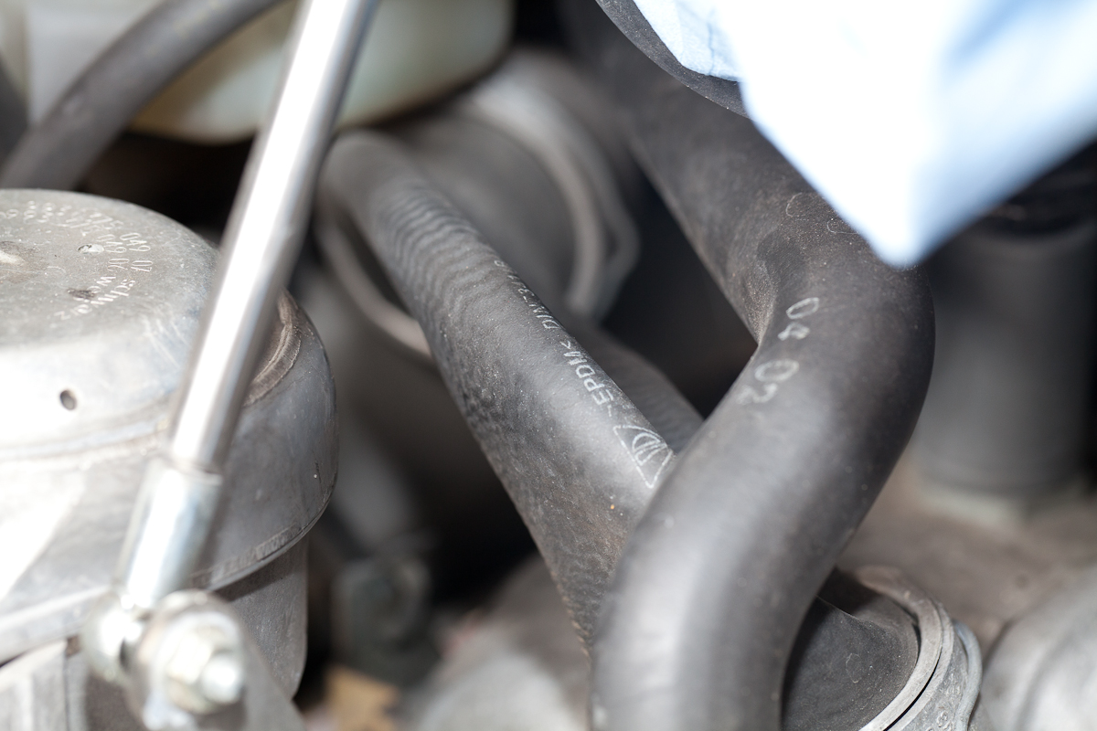

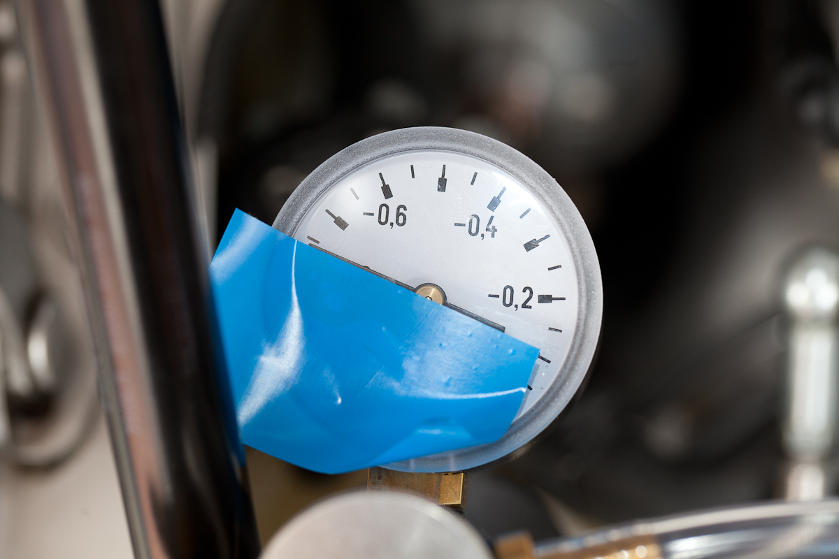

Nice DIY!
There is a specific procedure to refill the system. It requires a vacuum in the system and the Porsche PST tester has a specific routine to go through after the system has been refilled.
The vacuum pump is also good for checking if the system is sealed or not, before you refill it. See pictures.
The least you want to have is a larger air bubble that prevents proper cooling of the system, causing overheating in that certain area.
Andreas
