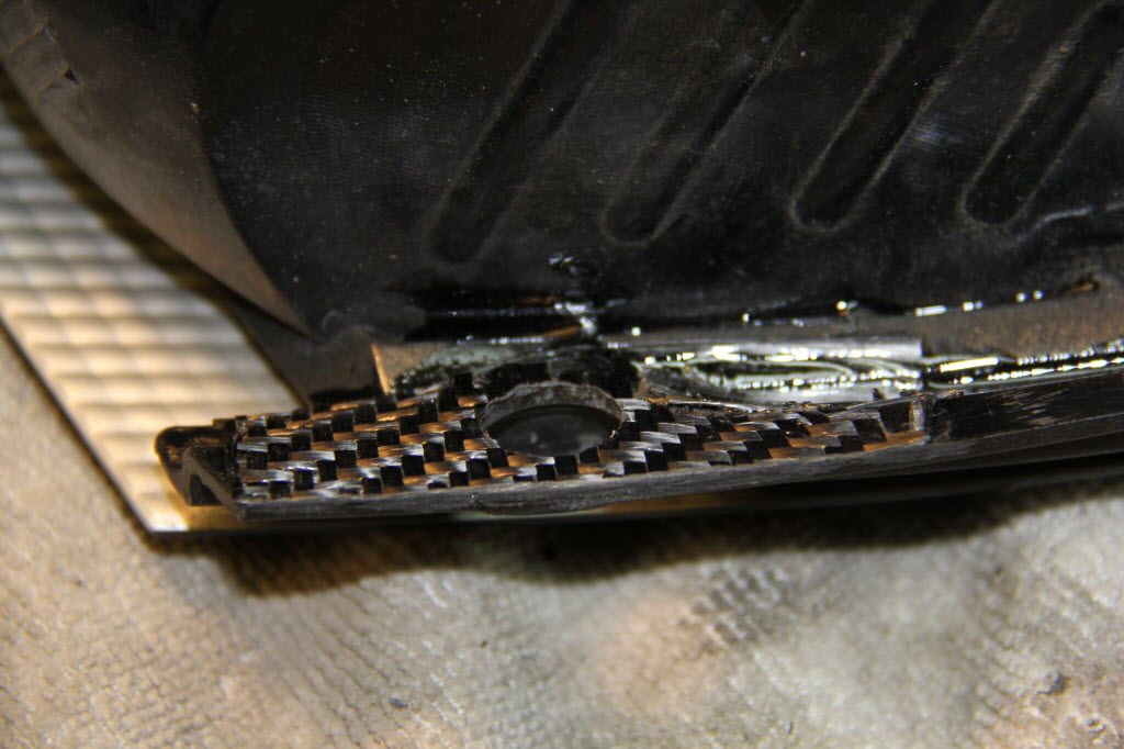

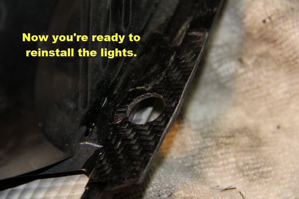

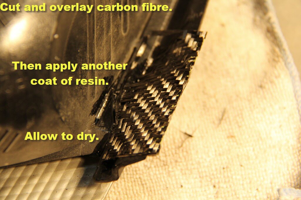

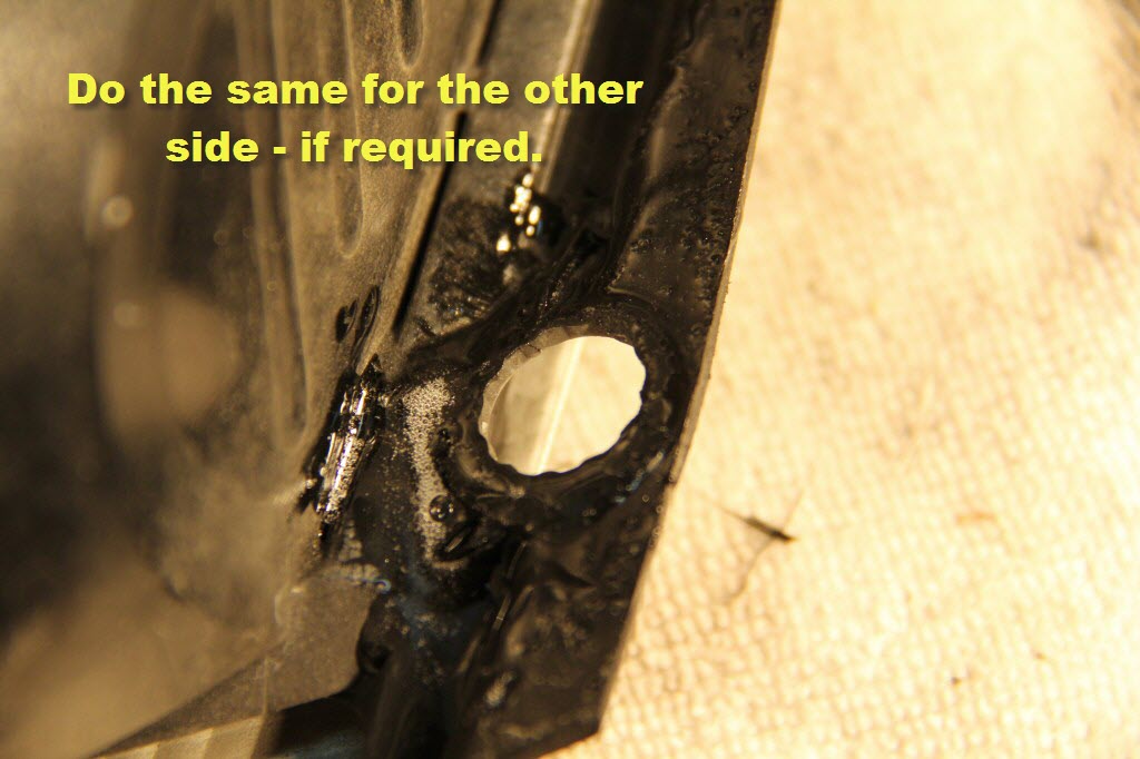

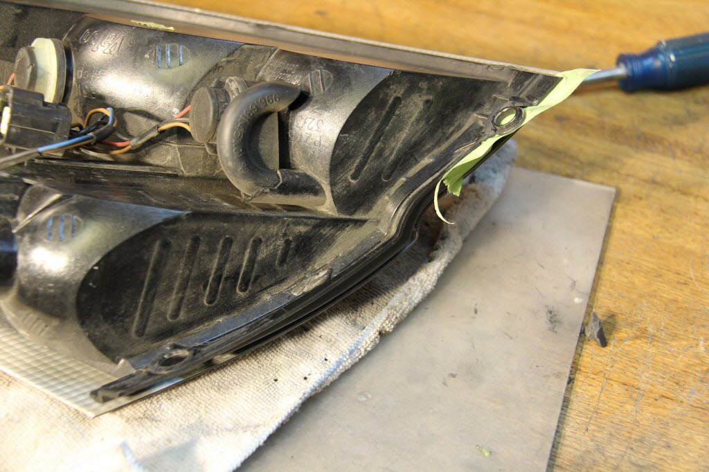

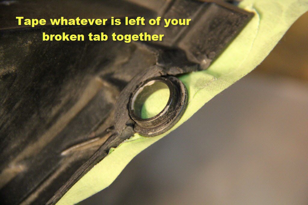

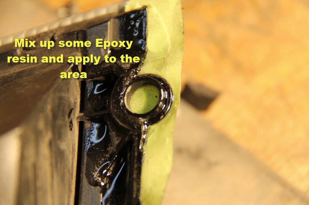

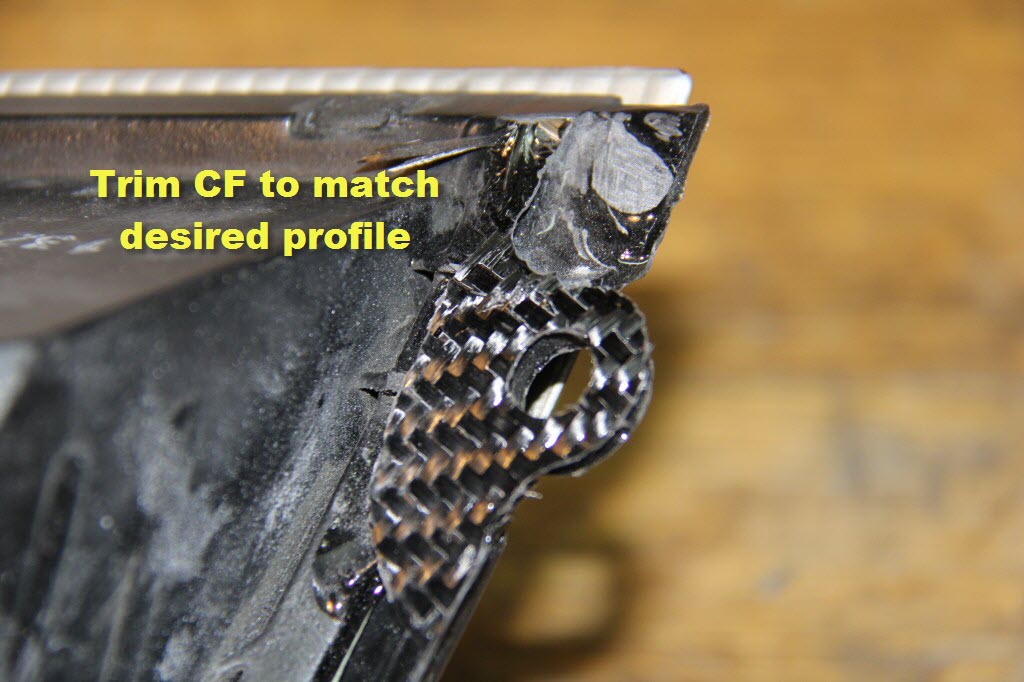

Since the LED tail replacement is moving so slowly, I thought I would post my solution to squeezing some more life out of the old tail lights before the replacements arrive. I did this over a year ago and they are still holding strong...

Fantastic job and information Slider. Thanks for sharing!!! I have to do the same thing soon but I have to admit the carbon fiber repair looks really nice!!!!

Where can one purchase bare carbon fiber?
Old Aug 12, 2013 | 03:25 PM
Slider's Avatar
Joined: Apr 2010
Posts: 2,164
From: Victoria, BC
Rep Power: 217
Slider Is a GOD !Slider Is a GOD !Slider Is a GOD !Slider Is a GOD !Slider Is a GOD !Slider Is a GOD !Slider Is a GOD !Slider Is a GOD !Slider Is a GOD !Slider Is a GOD !Slider Is a GOD !
This is where I get mine:
http://compositeenvisions.com/
Prices are good and it takes about a week to receive your order.

I also found some smaller pieces for less on ebay. IDK the quality, but I figure this will be a "learning" project , so I may just buy from there.
An inexpensive epoxy is what I'm still trying to figure out!
