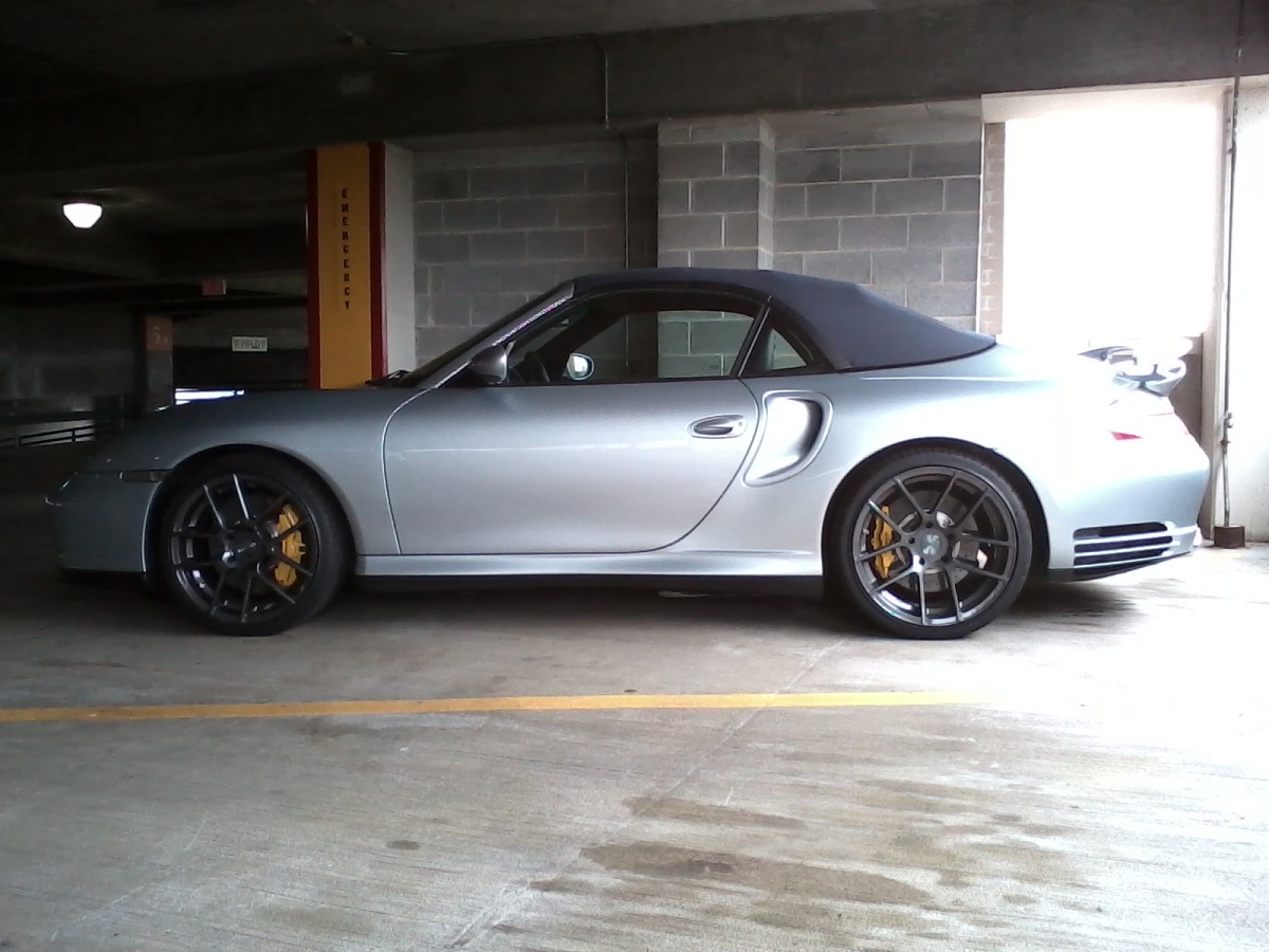

I'm running on 225/40-19's and 295/30-19's on H&R springs with spacers and have been very happy with the setup so far. It is the same as stock, just an in bigger in diameter. Here's a picture.
