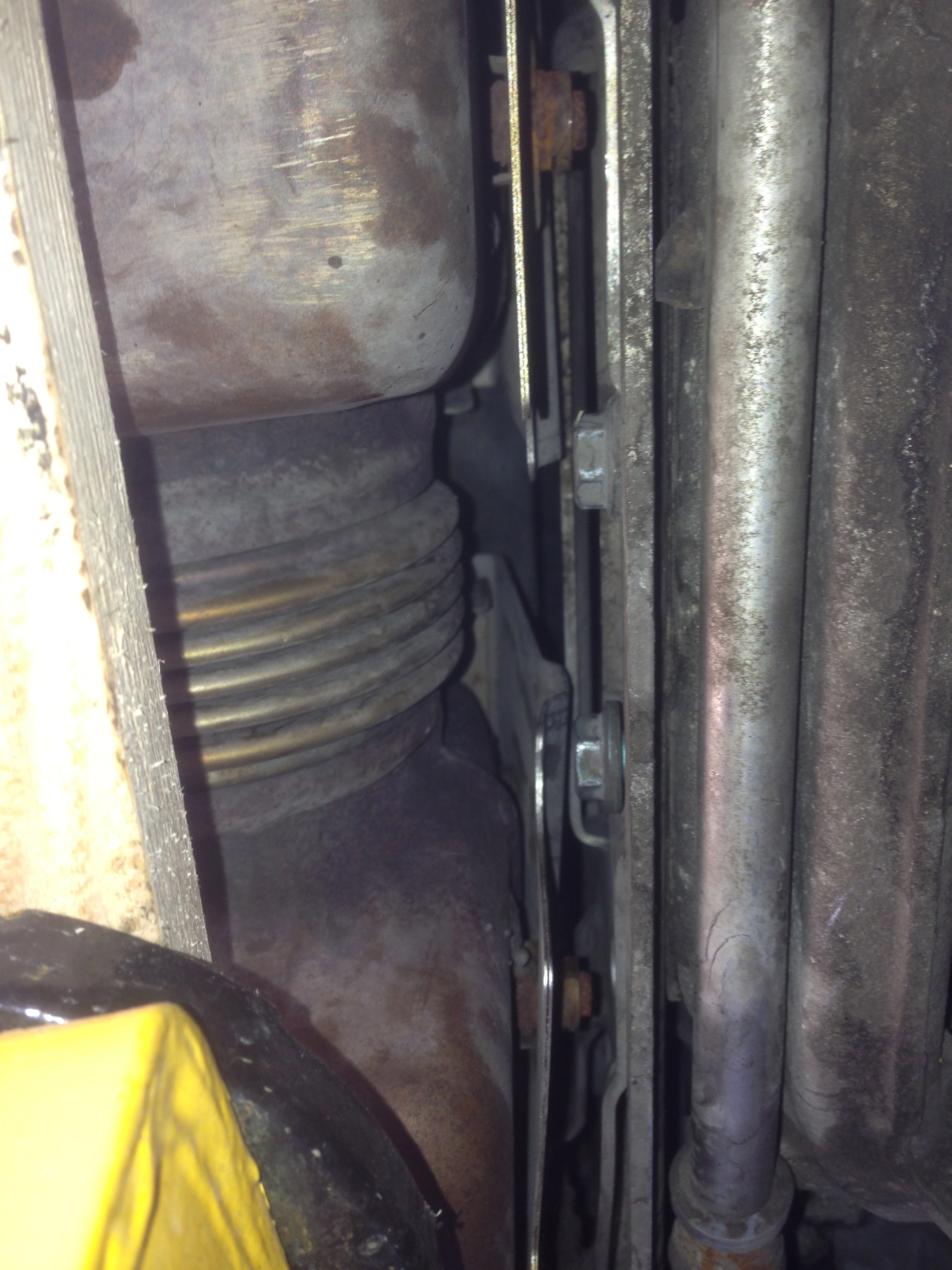

Got it! Im pretty impressed with how far I threw the nut. Took the bumper off which didn't really give me more access to the nut but it'll help dropping the exhaust.
New issue, all the bolts are gone, 2 hangers are removed and o2 sensors are removed....now there is something hanging up in the middle of the exhaust and it wont drop down at all. Here is a pick of 2 15mm bolts that are right in the middle, do they have to come out as well?

  #55
Nope. Just the 8 nuts to the turbo and the hangers. My guess is that the straps are not fully disengaged with the brackets in the back. Even though I could clearly see them, I still had to slide the straps farther to the outsides of car than I thought I would. Make sure you have a jack under the exhaust when you are tugging in case it lets loose.

  #56
+1 on what dsa22 just said. The hanger straps are probably still hanging up. Once they are out of the way, unhook the muffler from the cars' bracket by picking the muffler up and away. Keep the jack under the muffler to hold up that heavy muffler.

  #57
SUCCESS! Thanks guys
Just like that last nut it took some brute force to get everything loose.
