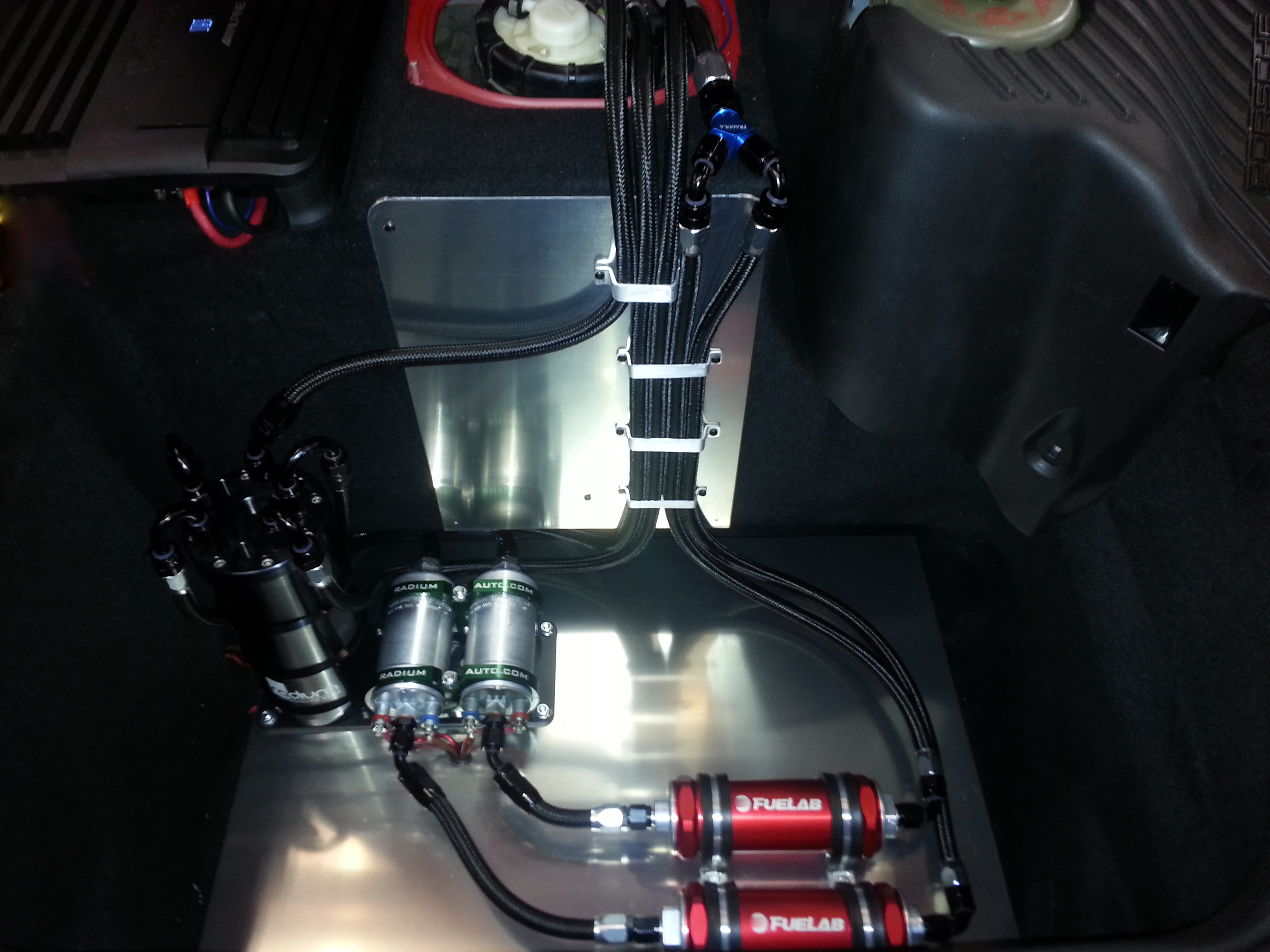

Finishing up a pretty involved build. E85 conversion, ProEfi em, Tial 3073s,
3.8 P&Cs, 997 GT2 main shaft w/ 1st-3rd gears and a complete custom
exhaust -intake setup and a grocery list of supporting mods and weight
reduction. The car weighs just a hair over 3000 lbs and were looking for
about 800 hp at the wheels. The car has a full carpeted interior with a/c
and a nice aftermarket sound system with bluetooth! Other than the cabin
being a little louder, not much has been sacrificed in the way of comfort.
I wanted to post a pic of the fuel system. Fred is a perfectionist and you
won't hear me complaining about his ocd!

nice i see what looks to be a radium canister, two 044's and the fuel labs, ? any other details?
what injectors are you going to run? and custom fuel rails?
2150cc injectors and custom rails. Fred passed on the crimp style fittings
and went with the threaded type and welded those on the rail. He also
configured the return lines so as to avoid the problem of air in the lines.
Yep, it's a radium setup with mostly aeromotive / fuel lab filters, lines and
fittings.
We're using a fuel lab adjustable fpr but found out there's a fair amount of
reported failures with that unit but it''s easily accessible from the engine bay
The ProEfi is supposed to really shine with e85 and we're excited to see
this all come together. Fred used Prodigies setup as a template and I
wanted to thank him for taking the time to put that thread together and
for answering Freds questions in a timely fashion.
Sam ( sambott ) was in charge of gathering info and parts and he is the
easiest most helpful guy to deal with! He knows everybody and he is
a real professional! I can't thank him enough!
