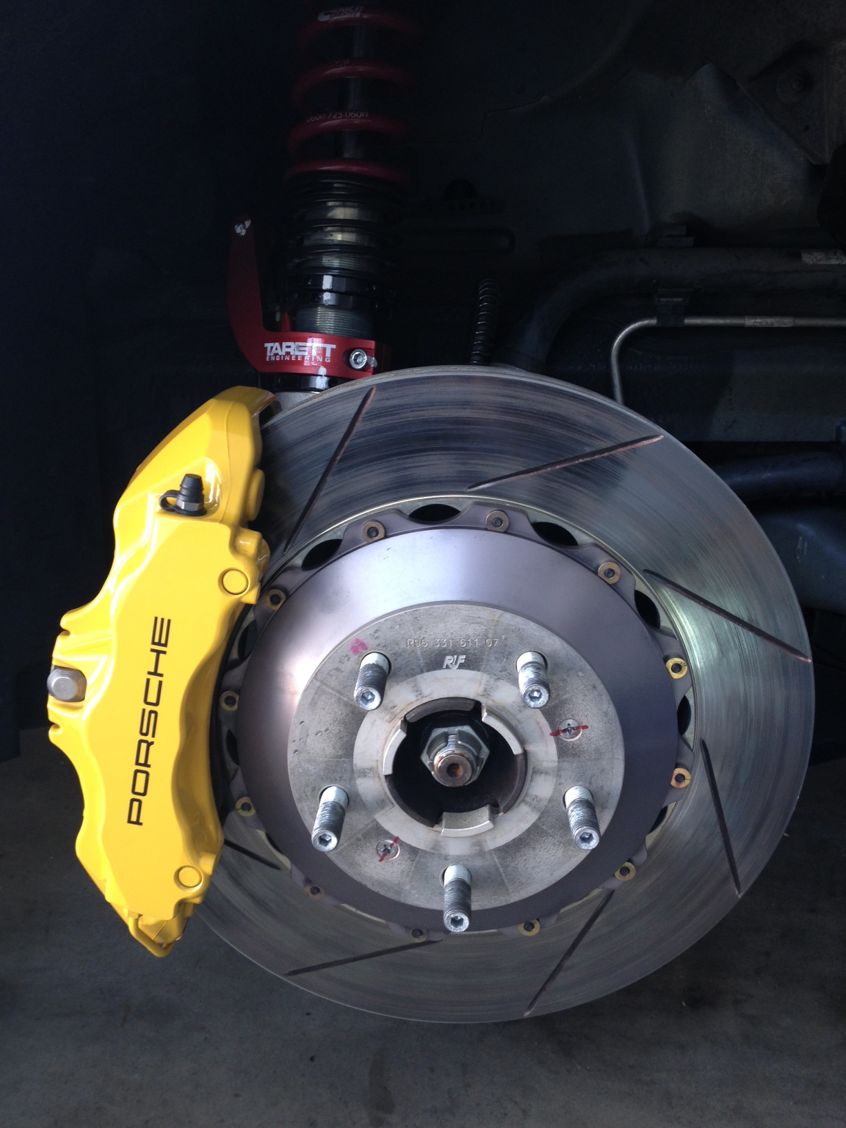

Good luck with the project Bastian. Feel free to contact me with any questions. Oh, and don't forget you'll need the Porsche Brembo adapters on the front. Here are the pics of the rotors I'm using.
Name:	997.2 PCCB 380mm brakes.jpg
ID:	264947   Click image for larger version
Name:	Rear 997 GT2 cooling duct:spoiler.jpg
